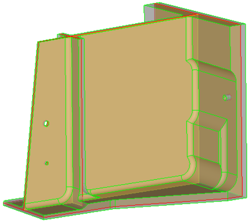

- Planes + Offsets
- Identify the places in the model where a piece of plane can be used as a
middle surface. At the remaining places in the model, for example the
places where planar pieces cannot be used as a middle surface, the same
algorithm as in Offsets is used to construct the middle surface via the
offset of the model's sides.

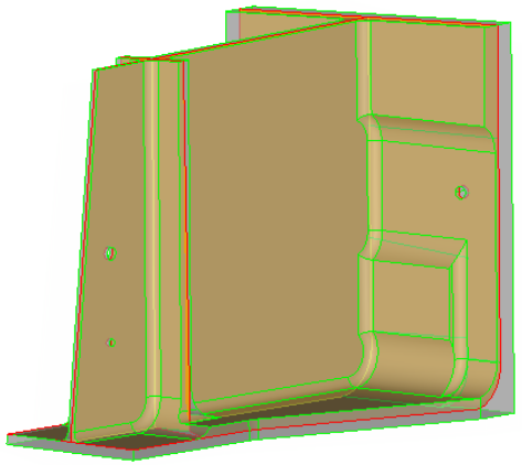

- Offsets
- Create pieces of the middle surface by offsetting the model's side
surfaces towards the middle. This is the traditional approach for
midsurfacing.
