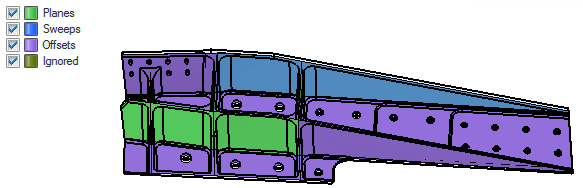

Midsurface plates are color coded by plate type.Figure 2.

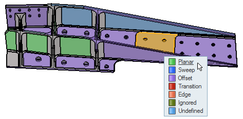

- Select surfaces to edit.
From the microdialog, select a new plate type.
Figure 3.
- On the guide bar, click Update Midsurfaces.

- Use the legend in the upper, left corner of the modeling window to show, hide, and isolate plate types.
