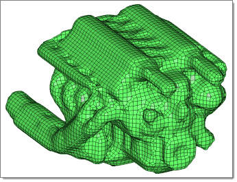

Loose wrap wraps the selected elements or components, surfaces, or solids with the target element size specified, and outputs an outer-volume mesh which approximately adheres to the original FE topology.
A smaller element size generates a shrink wrap mesh that more closely approximates the original FE representation and adheres to more features; a larger element size produces a more basic mesh which ignores more features. The loose wrap does not project the nodes of the shrink wrap mesh to the original mesh, and typically the shrink wrap mesh will have an offset from the original mesh, again, the offset is dependent on the target element size used.

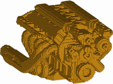

Comparison of Varying Mesh Sizes (Shell Output)
Comparison of Altering the Jacobian Value for Solid Mesh Generation
