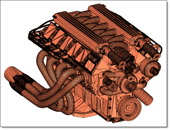

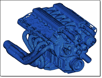

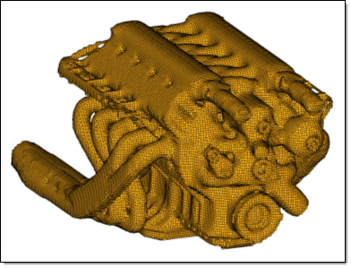

Notice the differences between tight and loose meshing, especially in the pulleys on
the front of the engine and the resulting width of the individual cylinder exhaust
pipes.Figure 1. Original Model
Figure 2. 2mm Tight Wrap
Figure 3. 2mm Loose Wrap

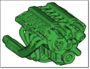

Comparison of Altering the Jacobian Value for Solid Mesh Generation
Within both tight and loose wrap algorithms there is an option to generate solid
mesh. This will generate an all-hexa mesh on completion of the shrink wrap. When the
generate solid mesh checkbox is active it exposes a
minimum jacobian input; this option essentially hexa meshes the part with this
element quality criteria defined. It controls the hexa quality which is directly
linked to the adherence to the topological features of the original component. The

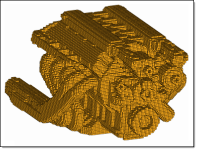

jacobian value must be between 0 and 1. The nearer the value is to 1 the cruder the
output will appear (the mesh will be more heavily voxelised). When the value is
closer to 0, you allow the shrink wrap solid mesh algorithm to smooth and adhere to
more features while maintaining the solid mesh minimum jacobian element quality. By
default the minimum jacobian value is 0.3.Figure 4. Original Model
Figure 5. 2mm Solid Mesh, Jacobian=1.0
