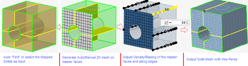

The above Map workflow helps you find mappable solids and auto-detect sources and targets. However, you can also select mappable solids manually and feed the source and target hints of your choice.
With this new workflow, you can define element size on source (main) surfaces and add density/biasing on source surface edges and along edges.
Finally, once you are done with 2D mesh editing, upon clicking Mesh, it'll create hexa-penta elements.
