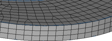

Tip: If you’d like to have biasing along the mesh direction, you need to select the biasing method and set up the appropriate parameters.The biasing affects element growth in successive layers, moving away from the source faces.
- No Biasing
- All layers are equal in thickness.
Figure 3. Example: No Biasing

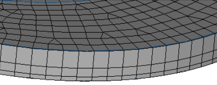

- Exponential Biasing
- Successive layers are exponentially thicker.
Figure 4. Example: Exponential Biasing
