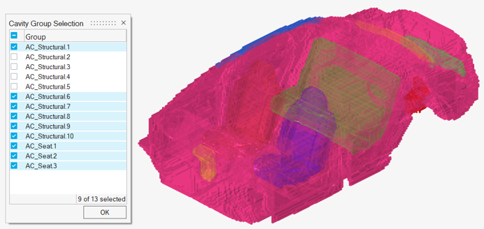

Click Preview to see the preview of the mesh.
Voxel-based preview of the mesh appears in the modeling window along with the list box. The entries in the list box allows you to show/hide/isolate the preview mesh. Select the preview mesh for which final acoustic cavity mesh needs to be created.
Figure 4. Simple Preview Mesh

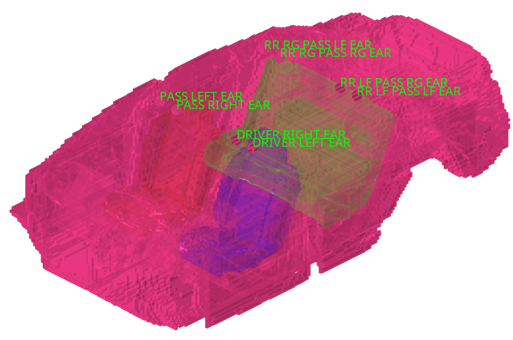

- Optional:

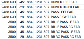

Select the response points from the .csv file.
Response points are defined in terms of nodal coordinates and tag label.
Figure 5.
Figure 6. Simple Preview Mesh with Response Points Information

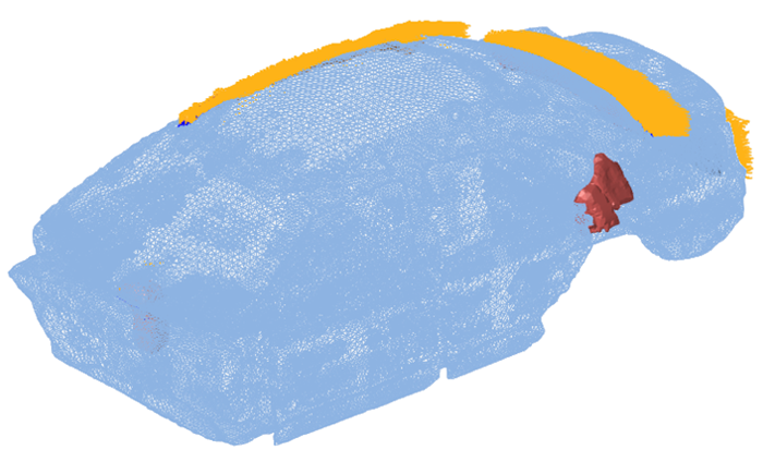

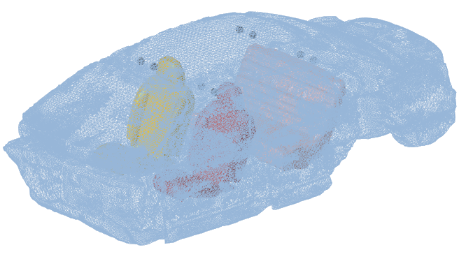

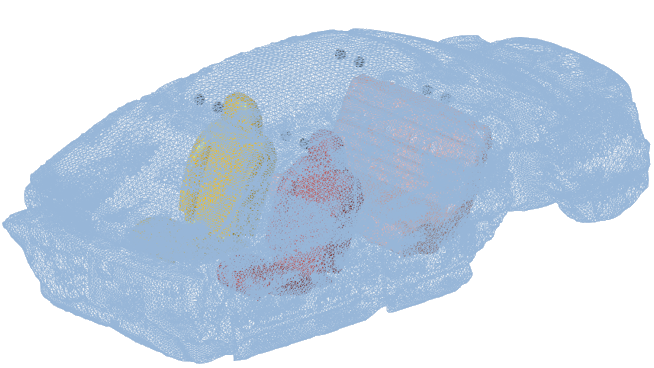

Create final acoustic mesh.
Figure 7. Final Acoustic Cavity Mesh

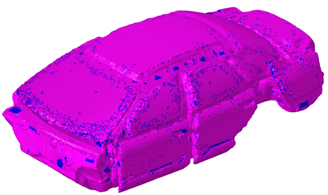

Show the interface.
This shows the coupling between structure and cavity indicating transfer of energy from structure to cavity. The pink color indicates properly coupled regions and blue color indicates uncoupled regions.
Figure 9. Fluid-Structure Interface
