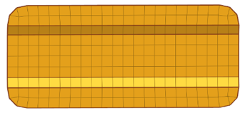

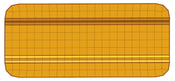

- Ignore flat edges
- Do not imprint flat edges from the input geometry onto the
midmesh.
Figure 2. Option Off
Figure 3. Option On

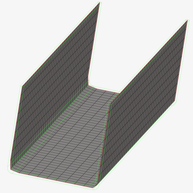

- Flatten connections
- Aligns/flattens the midmesh at ribs/connections.
Figure 4. Option Off
Figure 5. Option On

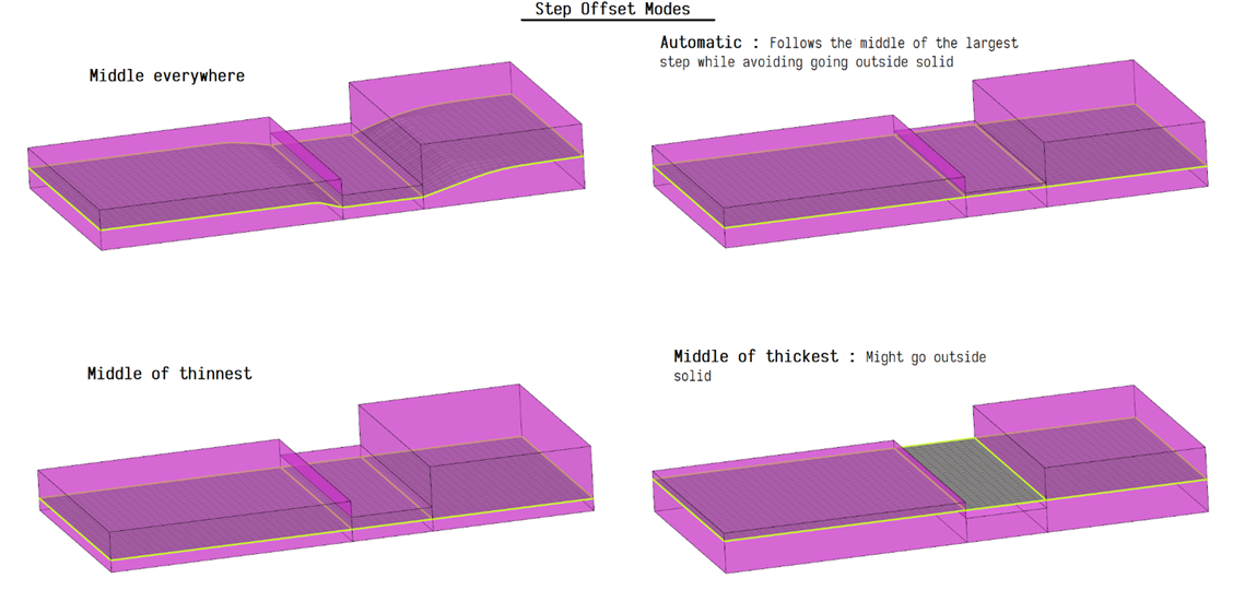

- Step offset mode
- This option allows finer control of how stepped geometry (one side continuous surface, and opposite side steps) is captured. This option is valid only when flatten connections is enabled. Values can be:
