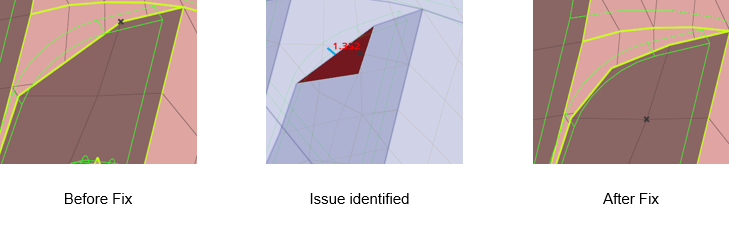

- Nodes off middle
- Finds all node cluster which are deviated from mid

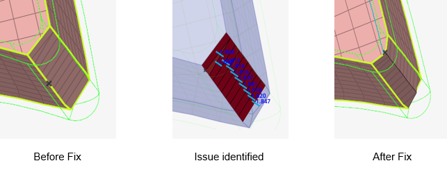

- Nodes off solid edge
- Finds all node cluster which are deviated from solid edge

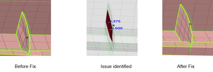

- Edges off of solid edge
- Finds all edge clusters which are deviated from solid edge.

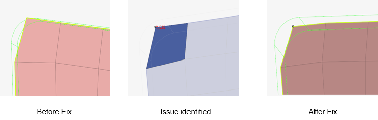

- Element centers off middle
- Finds all element clusters whose centers are deviated from mid
