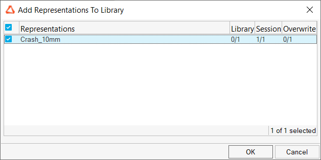

Add Representations to the Subsystem Library
Add representations to the library if they are in session only. This occurs when representations are saved but when not connected to a library (or when you uncheck the "Save to Library" option).
In the Subsystem Browser, right-click on a subsystem(s) and
select from the context menu.
The Add Representations to Library dialog opens.
- In the Add Representations to Library dialog, select the representations to add.
Click OK.
The Add Representation to Library dialog displays information regarding the availability of representations in library, session, and overwrite details.The image below shows that crash representation data is saved in session but is not saved to the library.

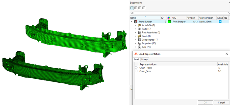

Load Representations From Current HyperMesh Session
Subsystem representations can be loaded from the current HyperMesh session.
The Load Representation dialog opens.
In the Load Representation dialog, Load tab, select a type
of representation to load.
Representations that exist in the repository are shown in the Representations column, and their availability is indicated in the Available column.

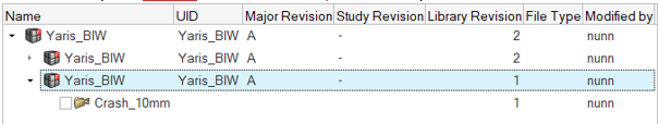

Browse Subsystem Library Content
Use the Library Viewer to review subsystem library content.
In the Subsystem Browser, right-click on the part assembly
or part(s) and select one of the following:
The Library Viewer opens.
Select the subsystem revision that you would like to review.
Figure 3.
Figure 4.

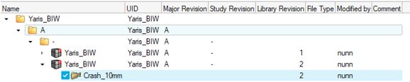

Select a representation you want to add to the session. You can select multiple
representations.
Figure 5.
- Optional: Select one of the added representations to load into the session.
- Click OK.
