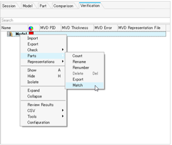

After the check, groups are created under the Part Browser/Part Set Browser. To execute the match, parts are mandatory. Select the root part from the Verification Browser or the Comparison Browser and run Match.
From the Verification Browser/Comparison Browser, right-click and select from the context menu.

Figure 3.
