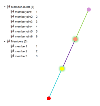

2. . Original model containing overlapping joints

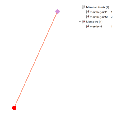

3. . Post equivalence the overlapping joints are consolidated
