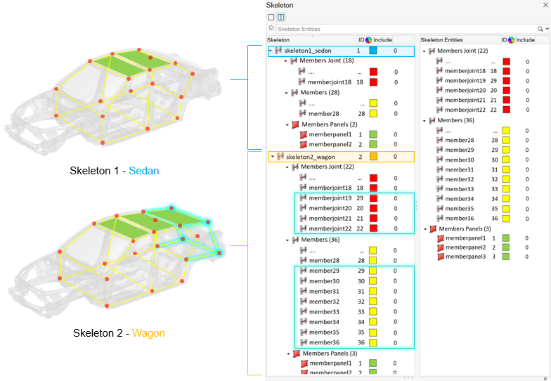

The browser provides two views – single pane for single variant, dual pane for managing multiple variants.
Variants are created by dragging and dropping from the main pane (right) to the secondary (left). Depending on what is selected, the appropriate entities are organized. For example, if a panel is organized to a new skeleton variant, then the members and member joints are organized too. Organizing a member will organize the two joints too.
The difference between the Wagon and Sedan variants are highlighted in blue.
