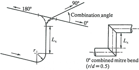

4 Number of bends
(NUM_BENDS)
Number of bends in the AT. Each bend is defined by a bend radius, bend angle, location in the AT (either distance from start of AT, or a specified straight segment length between bends), loss multiplier and combination angle.
5 Total Length
(LENGTH)
Length of the AT in inches. Do not include length within bends unless the bend losses are not otherwise accounted.

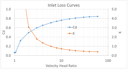

2) Upstream Cross Flow
The inlet loss is assumed to be due to a cross flow velocity at the inlet and is calculated according to Ref. 3.
The data used is for a tube with L/D > 2.83, where the flow has recovered from the inlet effects and is at right angles to the cross flow.
The method is valid for both upstream momentum and upstream inertial chambers. It is not valid for upstream plenum chambers.

A1 Bend Radius
(BEND_RADIUS)
(array of 20 values in 4 lines of 5 each, NUM_BENDS values used)
Radius (in) of bend along AT centerline.
(See ‘ r ’ from graphic for COMBINATION_ANGLE below)
Each bend counted in NUM_BENDS must have a specified bend radius. Enter bends in order based on distance from beginning of AT (DIST_FR_STRT).

A5 Combination Angle
(COMBINATION_ANGLE)
(array of 20 values in 4 lines of 5 each, NUM_BENDS minus one values used)
Relative angle (deg) between two bends in series.
The number of COMBINATION_ANGLE entries will be NUM_BENDS – 1. The first entry will be the combination angle between bends 1 and 2.
A COMBINATION_ANGLE of 0 degrees defines an ‘S’ shaped bend and 180 degrees defines a ‘U’ shaped bend.
Figure 2. Notation for combination of two 90° bends (Ref 5, pg. 228)
The allowable range is 0 to 180 degrees.

There is also an option to calculate an inlet K loss based on a built-in correlation based on data reported in Ref 3, Fig 8. Converting Cd from the plot to head loss using:
K i n = ( 1.0 C d ) 2 − 1.0 MathType@MTEF@5@5@+= feaagKart1ev2aqatCvAUfeBSjuyZL2yd9gzLbvyNv2CaerbuLwBLn hiov2DGi1BTfMBaeXatLxBI9gBaerbd9wDYLwzYbItLDharqqtubsr 4rNCHbGeaGqiVu0Je9sqqrpepC0xbbL8F4rqqrFfpeea0xe9Lq=Jc9 vqaqpepm0xbba9pwe9Q8fs0=yqaqpepae9pg0FirpepeKkFr0xfr=x fr=xb9adbiqaaeGaciGaaiaabeqaamaabaabaaGcbaaeaaaaaaaaa8 qacaWGlbWdamaaBaaaleaapeGaamyAaiaad6gaa8aabeaak8qacqGH 9aqpdaqadaWdaeaapeWaaSaaa8aabaWdbiaaigdacaGGUaGaaGimaa WdaeaapeGaam4qaiaadsgaaaaacaGLOaGaayzkaaWdamaaCaaaleqa baWdbiaaikdaaaGccqGHsislcaaIXaGaaiOlaiaaicdaaaa@4438@
V e l   H e a d   R a t i o = ( P t s − P s t u b e _ i n l e t ) ( P t s − P s u p s t r e a m   c h a m b e r ) MathType@MTEF@5@5@+= feaagKart1ev2aqatCvAUfeBSjuyZL2yd9gzLbvyNv2CaerbuLwBLn hiov2DGi1BTfMBaeXatLxBI9gBaerbd9wDYLwzYbItLDharqqtubsr 4rNCHbGeaGqiVu0Je9sqqrpepC0xbbL8F4rqqrFfpeea0xe9Lq=Jc9 vqaqpepm0xbba9pwe9Q8fs0=yqaqpepae9pg0FirpepeKkFr0xfr=x fr=xb9adbiqaaeGaciGaaiaabeqaamaabaabaaGcbaaeaaaaaaaaa8 qacaWGwbGaamyzaiaadYgacaGGGcGaamisaiaadwgacaWGHbGaamiz aiaacckacaWGsbGaamyyaiaadshacaWGPbGaam4Baiabg2da9maala aapaqaa8qadaqadaWdaeaapeGaamiuaiaadshapaWaaSbaaSqaa8qa caWGZbaapaqabaGcpeGaeyOeI0IaamiuaiaadohapaWaaSbaaSqaa8 qacaWG0bGaamyDaiaadkgacaWGLbGaai4xaiaadMgacaWGUbGaamiB aiaadwgacaWG0baapaqabaaak8qacaGLOaGaayzkaaaapaqaa8qada qadaWdaeaapeGaamiuaiaadshapaWaaSbaaSqaa8qacaWGZbaapaqa baGcpeGaeyOeI0IaamiuaiaadohapaWaaSbaaSqaa8qacaWG1bGaam iCaiaadohacaWG0bGaamOCaiaadwgacaWGHbGaamyBaiaacckacaWG JbGaamiAaiaadggacaWGTbGaamOyaiaadwgacaWGYbaapaqabaaak8 qacaGLOaGaayzkaaaaaaaa@6D37@
In addition to the inlet losses, pressure losses due to bends can also be included in the AT element. There are 2 ways to model bend losses in Flow Simulator: 1) include the bend in the AT element, 2) Use a separate bend element with the AT element only accounting for the straight length. Each method has advantages and disadvantages. Option 2 may lead to more accurate results and allows for the pressures upstream and downstream of the bends to be visible in the GUI. Option 1 is faster, and accuracy is sufficient for engineering calculations. If option 1 is used, the bend K loss is calculated the same way as the bend element K loss (see the bend element for calculation details).
