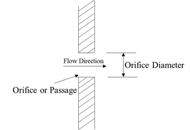

Orifice Element
The orifice element models a pressure loss between two chambers within a system, where the only purpose of the element is to model a flow restriction with losses within the system (for example, a simple aperture, coolers, strainers, fittings, leakages, or sudden changes in cross section). The orifice may be fixed in space or rotating about the engine centerline, and each may be positioned at any angle relative to the coordinate system. Orifice elements use an input of orifice mechanical area/diameter and loss parameters with a standard isentropic flow relationship to calculate the element flow rates. The loss parameter can be the Coefficient of discharge (Cd) or the Incompressible Loss Coefficient (K). This element does not model any fluid inertia.
Create Orifice Elements in the GUI
In Flow Simulator, there are different orifice element subtypes. All orifice elements can be used in compressible (for example, gas systems) and incompressible (for example, hydraulic and non-hydraulic systems) analysis. The subtypes are described below.
Conventional Orifice
Conventional orifice is a standard orifice element that requires the mandatory inputs cross section area or diameter and CD or K value.
  • Provide the nozzle efficiency to convert the conventional orifice to nozzle.

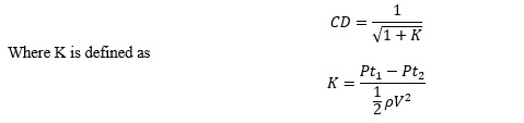

  • Cd (discharge coefficient) for an orifice element can be a value between 0+ and 1.0 as input.
  • Provide the Incompressible Loss coefficient (K) as input. Allowable Kloss values are 0 to 10. The discharge coefficient is calculated by the incompressible relationship:

Orifice Element Inputs
Element-Specific Conventional Orifice Element Input Variables
Index UI Name (.flo Label) Description
1 Area (AREA)
Diameter (DIA)
Orifice mechanical area
Orifice diameter

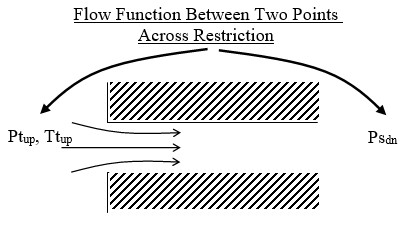

Orifice Theory Manual
The isentropic flow function defines the flow through an orifice restriction in terms of upstream total pressure, upstream total temperature, downstream static pressure, and cross-sectional flow area. Since the flow function is derived with the assumption of isentropic flow, some sort of empirical correction is required to account for the irreversible losses encountered in the orifices. This is usually represented as a discharge coefficient or loss coefficient, included in the working definition of the flow function, and represents the ratio of actual (empirical) to ideal (isentropic) flow rates.

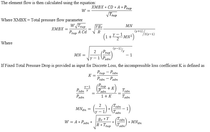

Flow Rate Calculation and Vena Contracta Mach Number - Conventional Orifice, Heater Cooler, and Discrete Loss
The element flow is calculated using the following equations:
Compressible flow:

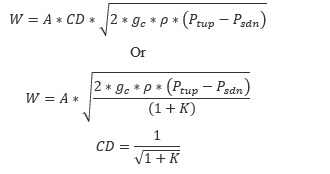

Incompressible flow equation:

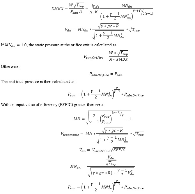

Orifice Exit Conditions Calculation
The flow is first expanded from the vena contracta throat to the exit conditions before any effect of heat addition, QIN, is considered. It is assumed that the flow is expanded adiabatically (limited to Mach number = 1.0) to the mechanical area of the orifice at the exit static pressure. The static pressure exit flow parameter, exit Mach number, and adiabatic exit velocity are calculated as:
The effect of heat addition specified as QIN is added next, assuming that only the exit temperature and velocity, and not the exit Mach number, are affected. The temperature rise (or drop if QIN is negative) is calculated using an average value of specific heat (Cp).
Cpavg: Specific heat at the average of TTS and TEX, pressure PSEX, and secondary fluid mass fraction FS(IC).
Next, a new exit velocity is calculated as:

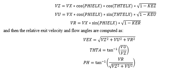

If 0 values are input for each of the exit head loss variables (KEZ, KEU, and KER), the element exit velocity, VEX, is set to VX, and the relative radial and tangential flow angles at the exit plane (THTA and PH) are taken to be the values specified for the input variables THTELX and PHIELX, respectively. If any of these exit head loss variables are input as non-zero values, the exit velocity components are recomputed as:

K Head loss coefficient
Calculated from the discharge coefficient using an equation.
unitless
