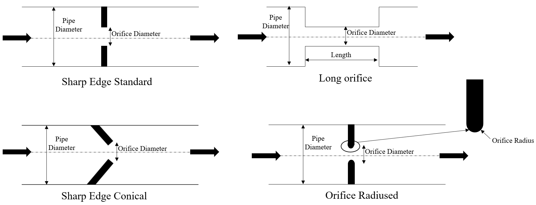

Orifice Plates Element Theory
K loss values for various Orifice Plate Configurations
Subtype Curve Reference
Orifice: Sharp-Edged
Forward Contraction Coefficient 90o (Miller, 2nd Ed., Fig 14.2)
Reverse Contraction Coefficient 90o (Miller, 2nd Ed., Fig 14.2)
Orifice: Sharp-Edged Conical
Forward Contraction Coefficient 45o (Miller, 2nd Ed., Fig 14.2)
Reverse Contraction Coefficient 45o (Miller, 2nd Ed., Fig 14.2)
Orifice: Long
Loss Coefficient for Thin Edged Sharp Orifice & Square Holes (Miller, 2nd Ed., Fig 14.3)
Correction Factor for Edged Radii (Miller, 2nd Ed., Fig 14.4)
Correction Factor for orifice length (Miller, 1st Ed., Fig 14.5)
Orifice: Short Loss Coefficient for Thin Edged Sharp Orifice & Square Holes (Miller, 2nd Ed., Fig 14.3)
Orifice: Radiused
Orifice: Square Loss Coefficient for Thin Edged Sharp Orifice & Square Holes (Miller, 2nd Ed., Fig 14.3)
Screens Loss Coefficient for Screens (Miller, 2nd Ed., Fig 14.7)
K for Grill at Inlet (Woods, reference 4)
K for Grill at Outlet (Woods, reference 4)

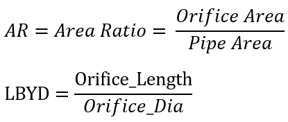

Apart from K Loss reference from “Internal Flow Systems” by DS Miller, Flow Simulator provides additional K Loss option from “Applied Fluid Dynamics, RD Blevins” (For Orifice Short Subtype) & I. E. Idelʹchik, Handbook of Hydraulic Resistance (For Orifice Long Subtype)
K Loss Calculation from IdelCheck for Long Orifice
Where
FRIC=Friction factor (Refer Solver General theory for Friction calculation)
PARAM1 = 1.0
PARAM2 = 1.5
PARAM3 = 2.0
IF (LBYD <= 0.2D0) THEN
TAU = 1.35D0 - 0.65D0 * LBYD
ELSEIF (LBYD <= 0.4D0) THEN
TAU = 1.34D0 - 0.60D0 * LBYD
ELSEIF (LBYD <= 0.6D0) THEN
TAU = 1.62D0 - 1.30D0 * LBYD
ELSEIF (LBYD <= 0.8D0) THEN
TAU = 2.10D0 - 2.10D0 * LBYD
ELSEIF (LBYD <= 1.0D0) THEN
TAU = 1.14D0 - 0.90D0 * LBYD
ELSEIF (LBYD <= 1.4D0) THEN
TAU = 0.59D0 - 0.35D0 * LBYD
ELSEIF (LBYD <= 2.0D0) THEN
TAU = 0.286666667D0 - 0.133333333D0 * LBYD
ELSEIF (LBYD <= 3.0D0) THEN
TAU = 0.06D0 - 0.02D0 * LBYD
ELSE
TAU = 0.0D0
ENDIF

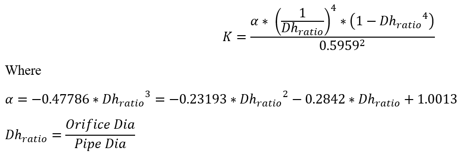

K Loss Calculation from RD Blevins for Short Orifice

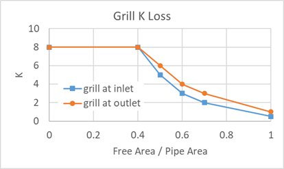

K Loss for Grills (Woods)
The K for a grill uses the area ratio (free unobstructed area over pipe area) and linear interpolation to get a K from this plot. The pipe area is used for reference velocity calculations.
Figure 3.

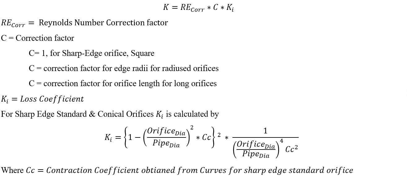

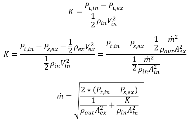

Incompressible Liquid Calculation:
The Incompressible total loss coefficient is given by
For all other subtypes, it is obtained directly from curve referenced above.
Mass flow rate across the element is calculated as follows

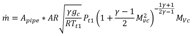

Compressible Gas Calculation:
Compressible Loss Coefficient, K is derived from incompressible loss coefficient, Ki with Compressibility correction factor. To obtain Compressibility correction coefficient, it is required to calculate the Mach number at Vena Contracta.
An iterative procedure is used to calculate mass flow rate & Mach Number at Vena contracta. The Compressibility Correction Coefficient is estimated using Curve (Fig 7.14 2 Ed., D.S. Miller)
