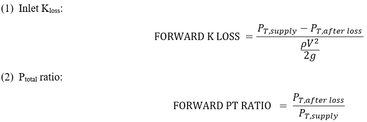

| 2 | Loss Option (LOSSFLAG) | Total Pressure Loss Flag. Available loss options are: 0.0: No Pressure Loss. 1.0: K-Loss Factor. 2.0: Exit PT over Inlet PT. Note: Options 1 and 2 Include extra P
total loss based on FWD_PLOSS and REV_PLOSS.
Note: The Ptotal loss due to
heat release is always calculated if temperature rises more
than 1% through the element.

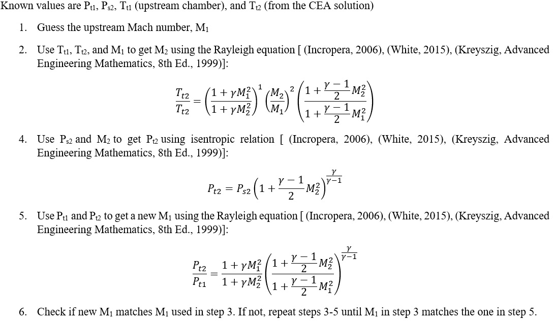

Rayleigh Loss Solution
In the combustion element using the Rayleigh Based flow mode, the total pressure loss due to combustion heat addition is modeled by satisfying the Rayleigh equations. Total pressure loss due to heat addition is typically small (less than 1 psi). Flow Simulator combustion elements use an iterative procedure to calculate pre- and post-combustion Mach numbers. The procedure is as follows

Loss Calculation
