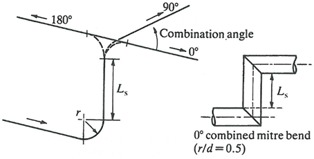

4 Number of bends
(NUM_BENDS)
Number of bends in the tube. Each bend is defined by a bend radius, bend angle, location in the tube (either distance from start of tube, or a specified straight segment length between bends), loss multiplier and combination angle.

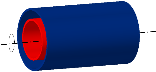

31 Inner Diameter (ID) Rotor Index
(RPMSEL_INNER)
The rotation of the inner diameter wall of an annulus. Used only for ROTATION_METH=1, Rotating Annulus.
0.0: Specifies a stationary inner annulus wall.
1.0: Rotor 1, RPM = general data ELERPM(1).
2.0: Rotor 2, RPM = general data ELERPM(2).
3.0: Rotor 3, RPM = general data ELERPM(3).

A1 Bend Radius
(BEND_RADIUS)
(array of 20 values in 4 lines of 5 each, NUM_BENDS values used)
Radius (in) of bend along tube centerline.
(See ‘ r ’ from graphic for COMBINATION_ANGLE below)
Each bend counted in NUM_BENDS must have a specified bend radius. Enter bends in order based on distance from beginning of tube (DIST_FR_STRT).

A5 Combination Angle
(COMBINATION_ANGLE)
(array of 20 values in 4 lines of 5 each, NUM_BENDS minus one values used)
Relative angle (deg) between two bends in series.
The number of COMBINATION_ANGLE entries will be NUM_BENDS – 1. The first entry will be the combination angle between bends 1 and 2.
A COMBINATION_ANGLE of 0 degrees defines an ‘S’ shaped bend and 180 degrees defines a ‘U’ shaped bend.
The allowable range is 0 to 180 degrees.
Figure 2. Notation for combination of two 90° bends (Ref 16, pg. 228)

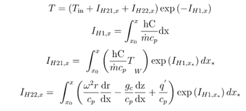

Energy Equation
Start with the differential form of the steady state energy balance equation:
d H d x = m ˙ C p d T d x = h C ( T w − T ) + m ˙ ( ω 2 r d r d x − g c d z d x ) + q i n ' ( x ) MathType@MTEF@5@5@+= feaagKart1ev2aqatCvAUfeBSjuyZL2yd9gzLbvyNv2CaerbuLwBLn hiov2DGi1BTfMBaeXatLxBI9gBaerbd9wDYLwzYbItLDharqqtubsr 4rNCHbGeaGqiVu0Je9sqqrpepC0xbbL8F4rqqrFfpeea0xe9Lq=Jc9 vqaqpepm0xbba9pwe9Q8fs0=yqaqpepae9pg0FirpepeKkFr0xfr=x fr=xb9adbiqaaeGaciGaaiaabeqaamaabaabaaGcbaaeaaaaaaaaa8 qadaWcaaWdaeaapeGaamizaiaadIeaa8aabaWdbiaadsgacaWG4baa aiabg2da9iqad2gapaGbaiaapeGaam4qa8aadaWgaaWcbaWdbiaadc haa8aabeaak8qadaWcaaWdaeaapeGaamizaiaadsfaa8aabaWdbiaa dsgacaWG4baaaiabg2da9iaadIgacaWGdbWaaeWaa8aabaWdbiaads fapaWaaSbaaSqaa8qacaWG3baapaqabaGcpeGaeyOeI0IaamivaaGa ayjkaiaawMcaaiabgUcaRiqad2gapaGbaiaapeWaaeWaa8aabaWdbi abeM8a39aadaahaaWcbeqaa8qacaaIYaaaaOGaamOCamaalaaapaqa a8qacaWGKbGaamOCaaWdaeaapeGaamizaiaadIhaaaGaeyOeI0Iaam 4za8aadaWgaaWcbaWdbiaadogaa8aabeaak8qadaWcaaWdaeaapeGa amizaiaadQhaa8aabaWdbiaadsgacaWG4baaaaGaayjkaiaawMcaai abgUcaRiaadghapaWaa0baaSqaa8qacaWGPbGaamOBaaWdaeaapeGa ai4jaaaakmaabmaapaqaa8qacaWG4baacaGLOaGaayzkaaaaaa@6519@
The incompressible tube uses the following energy integral [ref 5 section 1.6]:
These integrals are calculated in a semi-analytic way.
Integral I H 1 , x MathType@MTEF@5@5@+= feaagKart1ev2aqatCvAUfeBSjuyZL2yd9gzLbvyNv2CaerbuLwBLn hiov2DGi1BTfMBaeXatLxBI9gBaerbd9wDYLwzYbItLDharqqtubsr 4rNCHbGeaGqiVu0Je9sqqrpepC0xbbL8F4rqqrFfpeea0xe9Lq=Jc9 vqaqpepm0xbba9pwe9Q8fs0=yqaqpepae9pg0FirpepeKkFr0xfr=x fr=xb9adbiqaaeGaciGaaiaabeqaamaabaabaaGcbaaeaaaaaaaaa8 qacaWGjbWdamaaBaaaleaapeGaamisaiaaigdacaGGSaGaamiEaaWd aeqaaaaa@3A76@ is calculated as:
Integral I H 21 , x MathType@MTEF@5@5@+= feaagKart1ev2aqatCvAUfeBSjuyZL2yd9gzLbvyNv2CaerbuLwBLn hiov2DGi1BTfMBaeXatLxBI9gBaerbd9wDYLwzYbItLDharqqtubsr 4rNCHbGeaGqiVu0Je9sqqrpepC0xbbL8F4rqqrFfpeea0xe9Lq=Jc9 vqaqpepm0xbba9pwe9Q8fs0=yqaqpepae9pg0FirpepeKkFr0xfr=x fr=xb9adbiqaaeGaciGaaiaabeqaamaabaabaaGcbaaeaaaaaaaaa8 qacaWGjbWdamaaBaaaleaapeGaamisaiaaikdacaaIXaGaaiilaiaa dIhaa8aabeaaaaa@3B32@ is calculated as:
Where:
Integral I H 22 , x MathType@MTEF@5@5@+= feaagKart1ev2aqatCvAUfeBSjuyZL2yd9gzLbvyNv2CaerbuLwBLn hiov2DGi1BTfMBaeXatLxBI9gBaerbd9wDYLwzYbItLDharqqtubsr 4rNCHbGeaGqiVu0Je9sqqrpepC0xbbL8F4rqqrFfpeea0xe9Lq=Jc9 vqaqpepm0xbba9pwe9Q8fs0=yqaqpepae9pg0FirpepeKkFr0xfr=x fr=xb9adbiqaaeGaciGaaiaabeqaamaabaabaaGcbaaeaaaaaaaaa8 qacaWGjbWdamaaBaaaleaapeGaamisaiaaikdacaaIYaGaaiilaiaa dIhaa8aabeaaaaa@3B33@ is calculated as:
Finally, temperature at location x is calculated as:

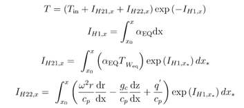

Multiple Wall Segment Case
In the case of an incompressible tube with multiple wall segments defined around the circumference of the tube, the differential form of the energy balance equation becomes:
where j is an individual circumferential wall segment.
Taking the first term on the right-hand side of the above equation:
In this equation, only the coefficients are different, and we can calculate an equivalent wall temperature:
Similarly, the total amount of external heat can be obtained:
And the differential form of the energy balance equation becomes:
In this case, the following integrals must be used to calculate temperature:
where:

Rotating Annulus and Coaxial Shaft Angular Momentum Balance
If the rotation method is “Rotating Annulus” or “Rotating Coaxial Shaft”, an angular momentum balance equation is solved to calculate the change of fluid swirl and fluid temperature due to windage. These rotation methods require that the element is attached to inertial chambers at each end. These rotation methods can be used instead of cavities for long annular or coaxial cylinders. For example, the Rotating Annulus method is used between the red and blue cylinders while the Rotating Coaxial Shaft is used inside the red cylinder in this figure.
Figure 3.
The angular momentum equation that is solved:
T q r − T q s = m ˙ * ω * R o u t * X K o u t − R i n * X K i n MathType@MTEF@5@5@+= feaahqart1ev3aqatCvAUfeBSjuyZL2yd9gzLbvyNv2CaerbuLwBLn hiov2DGi1BTfMBaeXatLxBI9gBaerbd9wDYLwzYbItLDharqqtubsr 4rNCHbGeaGqiVu0Je9sqqrpepC0xbbL8F4rqqrFfpeea0xe9Lq=Jc9 vqaqpepm0xbba9pwe9Q8fs0=yqaqpepae9pg0FirpepeKkFr0xfr=x fr=xb9adbaqaaeGaciGaaiaabeqaamaabaabaaGcbaaeaaaaaaaaa8 qacaWGubGaamyCa8aadaWgaaWcbaWdbiaadkhaa8aabeaak8qacqGH sislcaWGubGaamyCa8aadaWgaaWcbaWdbiaadohaa8aabeaak8qacq GH9aqpceWGTbWdayaacaWdbiaacQcacqaHjpWDcaGGQaWaaeWaa8aa baWdbiaadkfapaWaaSbaaSqaa8qacaWGVbGaamyDaiaadshaa8aabe aak8qacaGGQaGaamiwaiaadUeapaWaaSbaaSqaa8qacaWGVbGaamyD aiaadshaa8aabeaak8qacqGHsislcaWGsbWdamaaBaaaleaapeGaam yAaiaad6gaa8aabeaak8qacaGGQaGaamiwaiaadUeapaWaaSbaaSqa a8qacaWGPbGaamOBaaWdaeqaaaGcpeGaayjkaiaawMcaaaaa@5718@
T q r = t o r q u e   f r o m   t h e   r o t o r   s u r f a c e MathType@MTEF@5@5@+= feaahqart1ev3aqatCvAUfeBSjuyZL2yd9gzLbvyNv2CaerbuLwBLn hiov2DGi1BTfMBaeXatLxBI9gBaerbd9wDYLwzYbItLDharqqtubsr 4rNCHbGeaGqiVu0Je9sqqrpepC0xbbL8F4rqqrFfpeea0xe9Lq=Jc9 vqaqpepm0xbba9pwe9Q8fs0=yqaqpepae9pg0FirpepeKkFr0xfr=x fr=xb9adbaqaaeGaciGaaiaabeqaamaabaabaaGcbaaeaaaaaaaaa8 qacaWGubGaamyCa8aadaWgaaWcbaWdbiaadkhaa8aabeaak8qacqGH 9aqpcaWG0bGaam4BaiaadkhacaWGXbGaamyDaiaadwgacaGGGcGaam OzaiaadkhacaWGVbGaamyBaiaacckacaWG0bGaamiAaiaadwgacaGG GcGaamOCaiaad+gacaWG0bGaam4BaiaadkhacaGGGcGaam4Caiaadw hacaWGYbGaamOzaiaadggacaWGJbGaamyzaaaa@5695@
T q s = t o r q u e   f r o m   t h e   s t a t o r   s u r f a c e MathType@MTEF@5@5@+= feaahqart1ev3aqatCvAUfeBSjuyZL2yd9gzLbvyNv2CaerbuLwBLn hiov2DGi1BTfMBaeXatLxBI9gBaerbd9wDYLwzYbItLDharqqtubsr 4rNCHbGeaGqiVu0Je9sqqrpepC0xbbL8F4rqqrFfpeea0xe9Lq=Jc9 vqaqpepm0xbba9pwe9Q8fs0=yqaqpepae9pg0FirpepeKkFr0xfr=x fr=xb9adbaqaaeGaciGaaiaabeqaamaabaabaaGcbaaeaaaaaaaaa8 qacaWGubGaamyCa8aadaWgaaWcbaWdbiaadohaa8aabeaak8qacqGH 9aqpcaWG0bGaam4BaiaadkhacaWGXbGaamyDaiaadwgacaGGGcGaam OzaiaadkhacaWGVbGaamyBaiaacckacaWG0bGaamiAaiaadwgacaGG GcGaam4CaiaadshacaWGHbGaamiDaiaad+gacaWGYbGaaiiOaiaado hacaWG1bGaamOCaiaadAgacaWGHbGaam4yaiaadwgaaaa@5782@
m ˙ = m a s s   f l o w r a t e   t h r o u g h   t h e   t u b e   MathType@MTEF@5@5@+= feaahqart1ev3aqatCvAUfeBSjuyZL2yd9gzLbvyNv2CaerbuLwBLn hiov2DGi1BTfMBaeXatLxBI9gBaerbd9wDYLwzYbItLDharqqtubsr 4rNCHbGeaGqiVu0Je9sqqrpepC0xbbL8F4rqqrFfpeea0xe9Lq=Jc9 vqaqpepm0xbba9pwe9Q8fs0=yqaqpepae9pg0FirpepeKkFr0xfr=x fr=xb9adbaqaaeGaciGaaiaabeqaamaabaabaaGcbaaeaaaaaaaaa8 qaceWGTbWdayaacaWdbiabg2da9iaad2gacaWGHbGaam4Caiaadoha caGGGcGaamOzaiaadYgacaWGVbGaam4DaiaadkhacaWGHbGaamiDai aadwgacaGGGcGaamiDaiaadIgacaWGYbGaam4BaiaadwhacaWGNbGa amiAaiaacckacaWG0bGaamiAaiaadwgacaGGGcGaamiDaiaadwhaca WGIbGaamyzaiaacckaaaa@5674@
ω = r o t a t i o n a l   s p e e d   r a d / s MathType@MTEF@5@5@+= feaahqart1ev3aqatCvAUfeBSjuyZL2yd9gzLbvyNv2CaerbuLwBLn hiov2DGi1BTfMBaeXatLxBI9gBaerbd9wDYLwzYbItLDharqqtubsr 4rNCHbGeaGqiVu0Je9sqqrpepC0xbbL8F4rqqrFfpeea0xe9Lq=Jc9 vqaqpepm0xbba9pwe9Q8fs0=yqaqpepae9pg0FirpepeKkFr0xfr=x fr=xb9adbaqaaeGaciGaaiaabeqaamaabaabaaGcbaaeaaaaaaaaa8 qacqaHjpWDcqGH9aqpcaWGYbGaam4BaiaadshacaWGHbGaamiDaiaa dMgacaWGVbGaamOBaiaadggacaWGSbGaaiiOaiaadohacaWGWbGaam yzaiaadwgacaWGKbGaaiiOamaabmaapaqaa8qacaWGYbGaamyyaiaa dsgacaGGVaGaam4CaaGaayjkaiaawMcaaaaa@4F61@
X K in, out =Ratio of the fluid absolute rotational speed to the rotational                       reference frame at inlet and exit of the tube segment MathType@MTEF@5@5@+= feaahqart1ev3aqatCvAUfeBSjuyZL2yd9gzLbvyNv2CaerbuLwBLn hiov2DGi1BTfMBaeXatLxBI9gBaerbd9wDYLwzYbItLDharqqtubsr 4rNCHbGeaGqiVu0Je9sqqrpepC0xbbL8F4rqqrFfpeea0xe9Lq=Jc9 vqaqpepm0xbba9pwe9Q8fs0=yqaqpepae9pg0FirpepeKkFr0xfr=x fr=xb9adbaqaaeGaciGaaiaabeqaamaabaabaaGceaqabeaaqaaaaa aaaaWdbiaadIfacaWGlbWdamaaBaaaleaapeGaamyAaiaad6gacaGG SaGaaiiOaiaad+gacaWG1bGaamiDaaWdaeqaaOWdbiabg2da9iaadk facaWGHbGaamiDaiaadMgacaWGVbGaaiiOaiaad+gacaWGMbGaaiiO aiaadshacaWGObGaamyzaiaacckacaWGMbGaamiBaiaadwhacaWGPb GaamizaiaacckacaWGHbGaamOyaiaadohacaWGVbGaamiBaiaadwha caWG0bGaamyzaiaacckacaWGYbGaam4BaiaadshacaWGHbGaamiDai aadMgacaWGVbGaamOBaiaadggacaWGSbGaaiiOaiaadohacaWGWbGa amyzaiaadwgacaWGKbGaaiiOaiaadshacaWGVbGaaiiOaiaadshaca WGObGaamyzaiaacckacaWGYbGaam4BaiaadshacaWGHbGaamiDaiaa dMgacaWGVbGaamOBaiaadggacaWGSbaabaGaaiiOaiaacckacaGGGc GaaiiOaiaacckacaGGGcGaaiiOaiaacckacaGGGcGaaiiOaiaaccka caGGGcGaaiiOaiaacckacaGGGcGaaiiOaiaacckacaGGGcGaaiiOai aacckacaGGGcGaaiiOaiaadkhacaWGLbGaamOzaiaadwgacaWGYbGa amyzaiaad6gacaWGJbGaamyzaiaacckacaWGMbGaamOCaiaadggaca WGTbGaamyzaiaacckacaWGHbGaamiDaiaacckacaWGPbGaamOBaiaa dYgacaWGLbGaamiDaiaacckacaWGHbGaamOBaiaadsgacaGGGcGaam yzaiaadIhacaWGPbGaamiDaiaacckacaWGVbGaamOzaiaacckacaWG 0bGaamiAaiaadwgacaGGGcGaamiDaiaadwhacaWGIbGaamyzaiaacc kacaWGZbGaamyzaiaadEgacaWGTbGaamyzaiaad6gacaWG0baaaaa@C86B@
R i n , o u t = F l o w   r a d i u s   a t   i n l e t   a n d   e x i t   o f   t h e   t u b e   s e g m e n t MathType@MTEF@5@5@+= feaahqart1ev3aqatCvAUfeBSjuyZL2yd9gzLbvyNv2CaerbuLwBLn hiov2DGi1BTfMBaeXatLxBI9gBaerbd9wDYLwzYbItLDharqqtubsr 4rNCHbGeaGqiVu0Je9sqqrpepC0xbbL8F4rqqrFfpeea0xe9Lq=Jc9 vqaqpepm0xbba9pwe9Q8fs0=yqaqpepae9pg0FirpepeKkFr0xfr=x fr=xb9adbaqaaeGaciGaaiaabeqaamaabaabaaGcbaaeaaaaaaaaa8 qacaWGsbWdamaaBaaaleaapeGaamyAaiaad6gacaGGSaGaam4Baiaa dwhacaWG0baapaqabaGcpeGaeyypa0JaamOraiaadYgacaWGVbGaam 4DaiaacckacaWGYbGaamyyaiaadsgacaWGPbGaamyDaiaadohacaGG GcGaamyyaiaadshacaGGGcGaamyAaiaad6gacaWGSbGaamyzaiaads hacaGGGcGaamyyaiaad6gacaWGKbGaaiiOaiaadwgacaWG4bGaamyA aiaadshacaGGGcGaam4BaiaadAgacaGGGcGaamiDaiaadIgacaWGLb GaaiiOaiaadshacaWG1bGaamOyaiaadwgacaGGGcGaam4Caiaadwga caWGNbGaamyBaiaadwgacaWGUbGaamiDaaaa@6DA0@
The flow radius is always the center of an annulus, but the flow radius is not well defined for a Rotating Coaxial Shaft. You must supply the flow radius for the Rotating Coaxial Shaft method. If the flow radius is 0, the XK=1 and the fluid is rotating at the same speed as the shaft. A flow radius of 0.25 times the shaft diameter is a good value to use unless experience indicates a different value.
The torque equations use the same skin friction coefficient equations used for cylindrical surfaces in cavities.
The Reynolds number will use an effective velocity based on axial and rotational velocities. This effective Reynolds number is used in the heat transfer coefficient and friction calculations. Furthermore, the friction uses an effective length to account for the spiral path of the flow through the tube. See reference 8 by Gazley.
