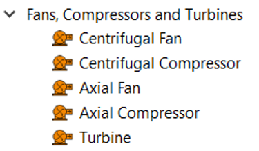

Flow Simulator has four subtypes of Fans and Compressors, and one Turbine, which are available only in Compressible (for example, gas systems) Gas Elements which can be used for piping system simulation.
  1. Centrifugal Fan
  2. Centrifugal Compressors
  3. Axial Fan
  4. Axial Compressors
  5. Axial turbine

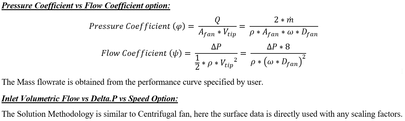

For Axial Fan, users provided Surface data “Volumetric Flow rate vs. Delta.P vs Speed” obtained from manufacturer. Since this Surface data consist of Fan Performance curves for various speeds, no scaling is used.

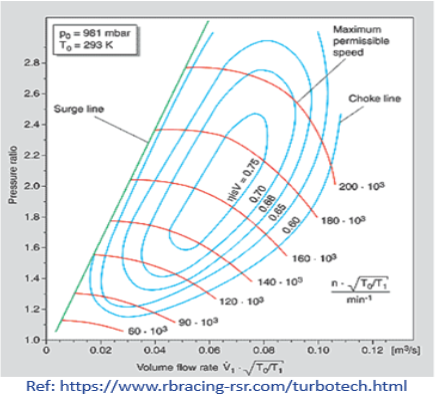

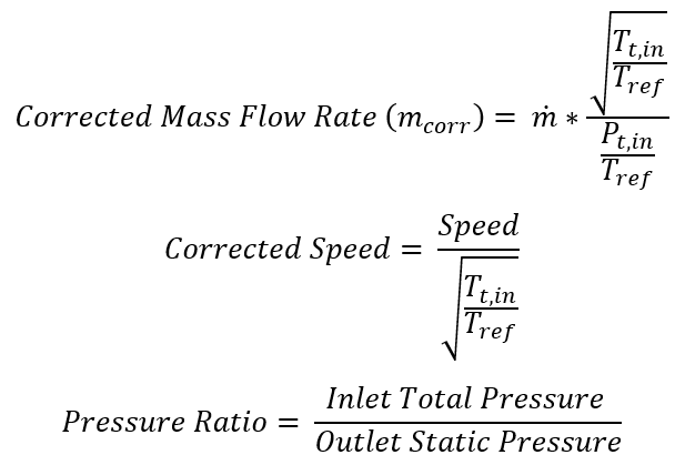

Axial Compressors models a simple compressor. The performance of the compressor is determined by its performance map. The map shows the relationship between the pressure ratio and volumetric or mass flow rate. The usable section of the map is defined by the Surge and Choke lines and the maximum compressor speed. The red lines show increasing compressor speeds.
Surge Line
This is the point at which the air flow stalls at the compressor inlet. If the volume flow is too small or the pressure ratio is too high, then the air flow can longer adhere to the suction side of the compressor blades, which interrupts the discharge process. The air flow through the compressor is reversed until a stable pressure ratio with positive flow rate is reached. The pressure then builds up again and the cycle repeats itself. This flow instability continues at a fixed frequency and the resultant noise is referred to as 'surging'.
Choking Line

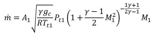

The maximum centrifugal compressor rate is normally limited by the cross-section at the compressor inlet. When the flow at the compressor wheel reaches sonic velocity, no further flow rate increase is possible. The choke line is shown in Figure 2 bisecting the descending compressor speed lines.

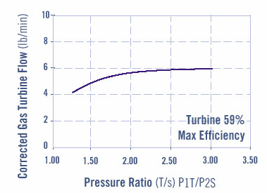

Axial Turbines models a simple Turbine. The performance of the turbine is determined by its performance map. The Typical turbine map below shows the relationship between the pressure ratio and volumetric or mass flow rate & Efficiency.
Fig: Turbine Performance Map

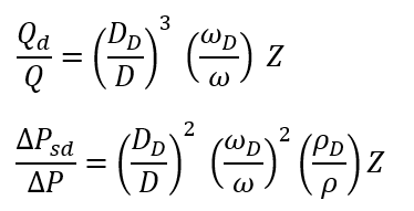

Centrifugal Fan and Centrifugal Compressor:
Performance changes due to these differences are scaled according to the Affinity Laws, which is a close approximation though not precise for compressible gases.
Solution Methodology:
  1. Actual Inlet Flow Rate at current operating conditions is converted to equivalent flow at the Design Point, using the Affinity Laws, the flow is limited to lie between Surge Flow Rate and Choking Flow Rate and performance characteristics are read at that Flow Rate.
  2. The Pressure (Difference) and Power read from the curves are then converted back to actual values at current operating conditions for use in the simulation or results.

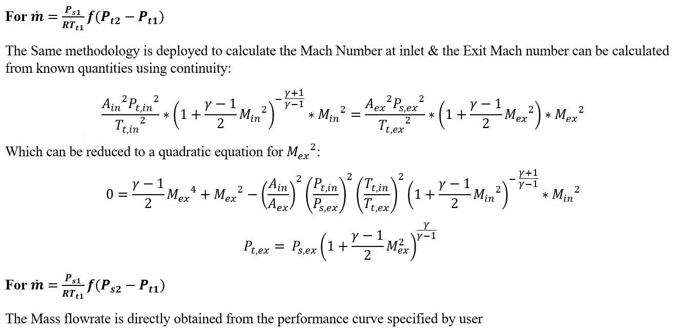

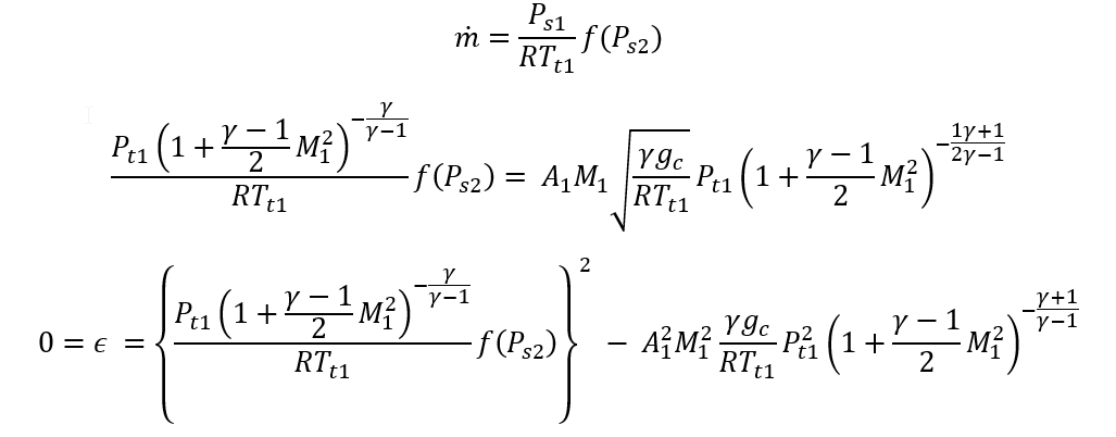

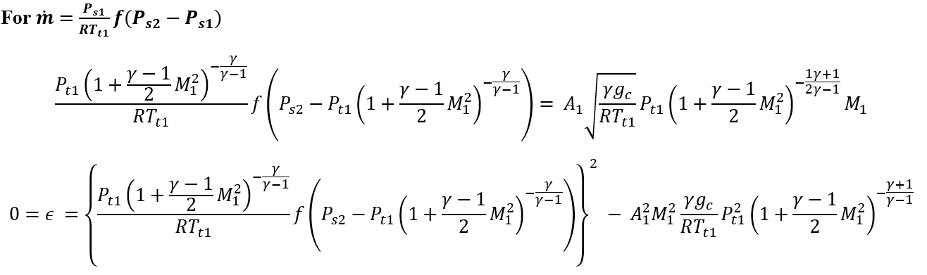

The Actual inlet Mass flow rate is determined by following procedure.,
For Centrifugal Compressor,
Newton-Raphson method is used to solve above mentioned coupled continuity and momentum equations to Mass Flow rate.
For Fan Centrifugal,
Axial Fan
