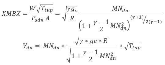

Fixed Flow Element Theory
If the element is declared to be subtype 1 and subtype 3, the flow going into the downstream chamber is the value input for flow (FLOW). For subtype 2, the flow going into the downstream chamber is:
If Exit Area is greater than 0, then
For Incompressible flow:
For Compressible Flow:
XMBX = Total pressure flow parameter
| Nomenclature | Subscripts |
| W: Mass flow rate | up: Upstream station |
| Tt: Total Temperature | dn: Downstream station |
| Pt: Total pressure | ref: Reference |
| Ps: Static pressure | |
| Specific heat Ratio | |
| R: Gas Constant | |
| Density | |
| MN: Vena Contracta Mach Number | |
| gc: Gravitational Constant |
