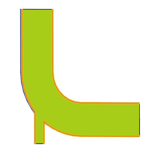

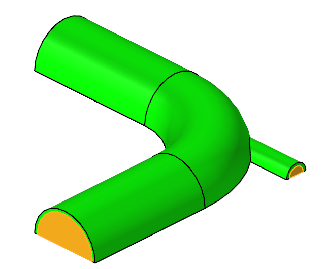

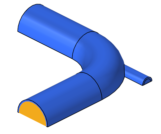

The problem to be addressed in this tutorial is shown schematically in Figure 1. It consists of a mixing elbow made of stainless steel with water entering through two inlets with different velocities and at different temperatures. The geometry is symmetric about the XY midplane of the pipe, as shown in the figure.

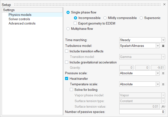

The Setup dialog opens. -
Under the Physics models setting:
Figure 5.

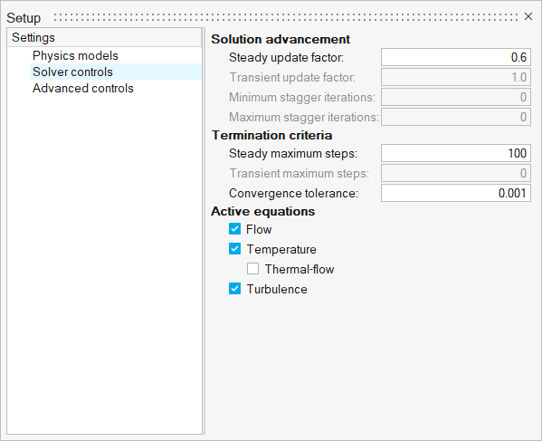

Click the Solver controls setting and verify that the
parameters are set as shown in the figure below.
Figure 6.

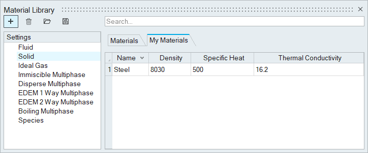

Create a New Material Model
From the Flow ribbon, click the Material Library tool.
Figure 7.
The Material Library opens. - Under Settings, click Solid.
Click the My Materials tab then click
to
create a new solid.
A material creation dialog opens. -
Rename the material.
- In the top-left of the dialog, click Solid to edit the name.
- Type Steel and press Enter.
Change the Density value to 8030.
Figure 8.
- Click the Specific Heat tab.
Change the Specific heat value to 500.
Figure 9.
- Click the Conductivity tab.
Change the Conductivity value to 16.2.
Figure 10.

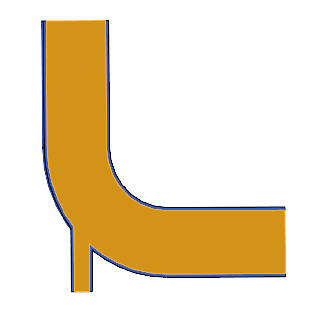

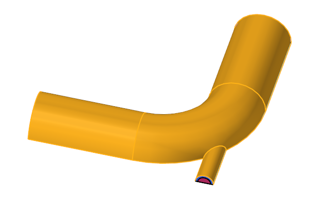

Select the outer pipe solid.
Figure 13.
- In the microdialog, click the drop-down menu next to Material and select Steel.

Assign Flow and Thermal Boundary Conditions
Set Boundary Conditions for the Large Inlet
From the Flow ribbon, Profiled
tool group, click the Profiled Inlet tool.
Figure 15.

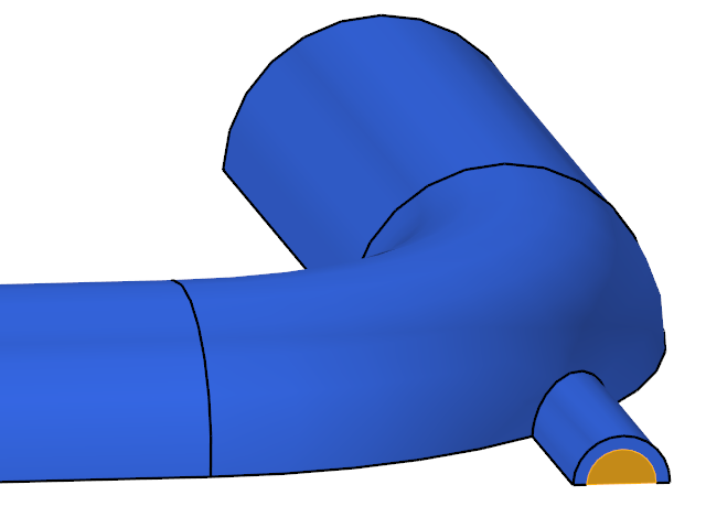

Click the face of the large inlet.
Figure 16.
- In the microdialog, enter a value of 0.4 for Average velocity and 295 for Temperature.

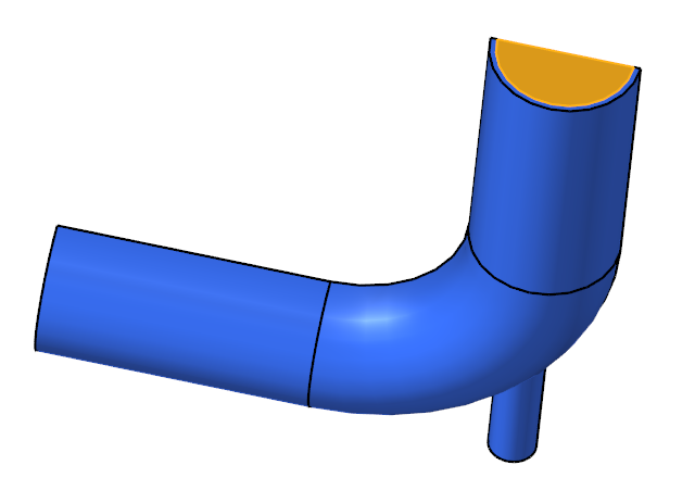

Set Boundary Conditions for the Outlet
From the Flow ribbon, click the Outlet tool.
Figure 18.
Click the face of the outlet.
Figure 19.

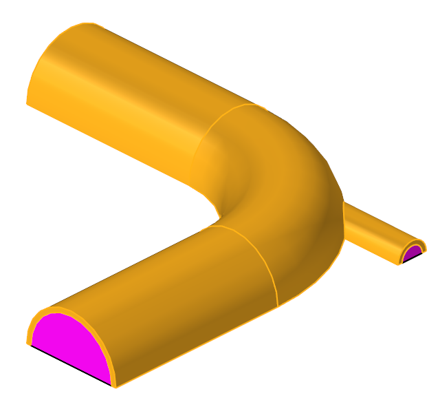

Set Boundary Conditions for the Symmetry Planes
This geometry is symmetric about the XY midplane, and can therefore be modeled with half of the geometry. In order to take advantage of this, the midplane needs to be identified as a symmetry plane. The symmetry boundary condition enforces constraints such that the flow field from one side of the plane is a mirror image of that on the other side.
From the Flow ribbon, click the Symmetry tool.
Figure 21.
Click the face of the symmetry plane.
Figure 22.
In the microdialog, accept the
default symmetry conditions.
Figure 23.

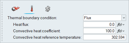

to open
the temperature tab.
- Change the Convective heat coefficient value to 100.
Change the Convective heat resistance temperature value to
302.594.
Figure 27.

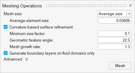

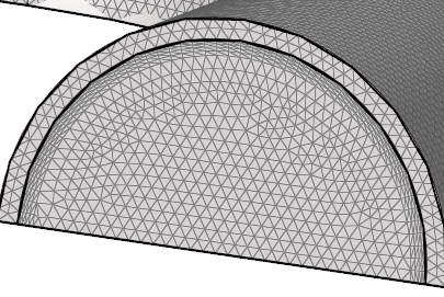

From the Mesh ribbon, click the
Volume tool.
Figure 28.
The Meshing Operations dialog opens.Note: If the model has not been validated, you are prompted to create the simulation model before running the batch mesh. - Check that the Average element size is 0.03606.
Accept all other default parameters.
Figure 29.
Click Mesh.
The Run Status dialog opens. Once the run is complete, the status is updated and you can close the dialog.Tip: Right-click on the mesh job and select View log file to view a summary of the meshing process.
Observe the refined mesh around the pipe walls.

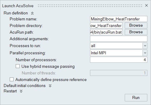

Figure 31.
The Launch AcuSolve dialog opens. - Set the Parallel processing option to Intel MPI.
- Deactivate the Automatically define pressure reference option.
Leave the remaining options as default and click
Run to launch AcuSolve.
Figure 32.

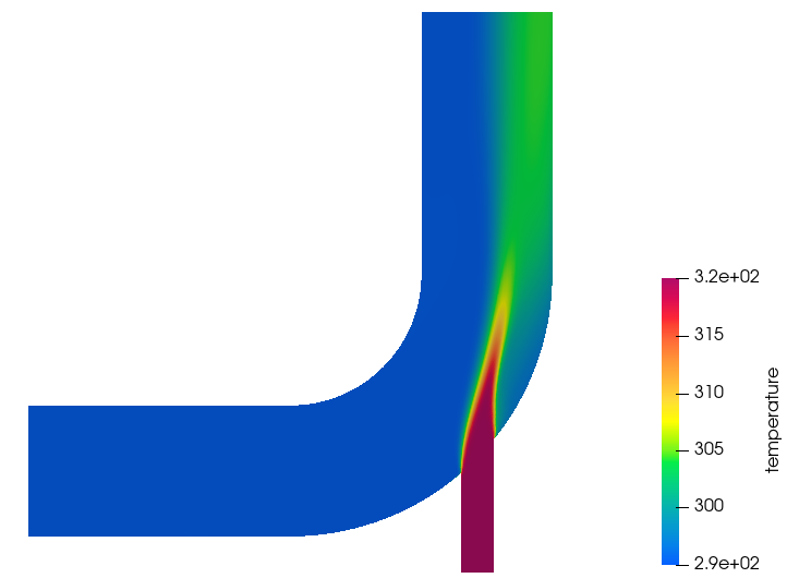

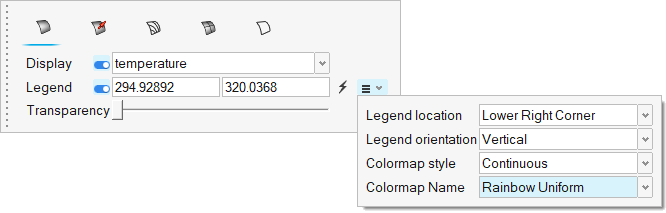

- Isolate the Symmetry flow boundary in the Post Browser.
- Right-click on the Symmetry and select Edit.

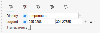

- In the display properties microdialog, set the display to temperature and activate the Legend toggle.
Click
and set the Colormap Name to Rainbow
Uniform.
Figure 33.

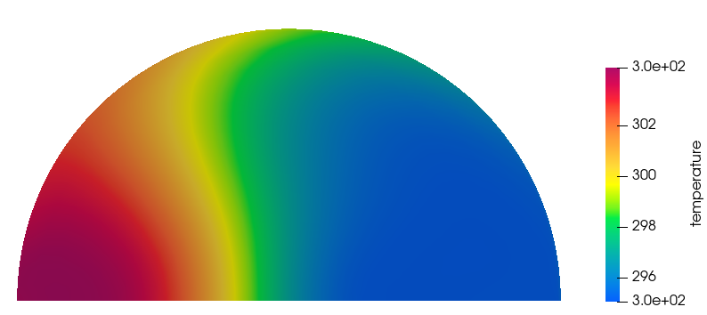

- Isolate the Outlet flow boundary in the Post Browser.
Click the Right face on the View Cube to align the
model.
Figure 35.
Tip: If the orientation is not the standard, click the face again to re-align the model back to the standard orientation. - Right-click on Outlet and select Edit.
- Display the temperature.
Click
to reset the range.
Figure 36.
