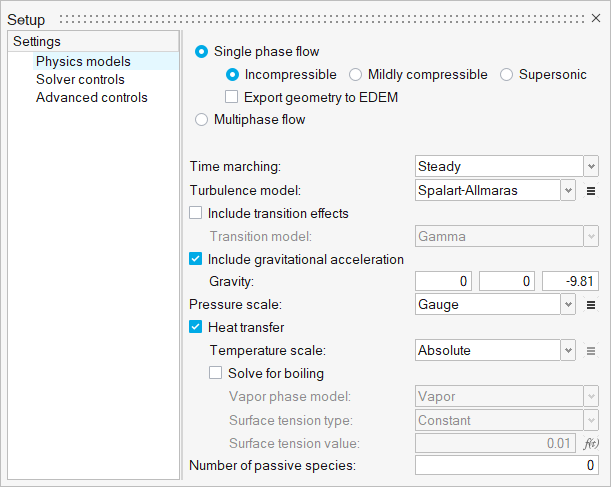

The Setup dialog opens. -
Under the Physics models setting:
- Set Time marching to Steady.
- Select Spalart-Allmaras as the Turbulence model.
- Activate the Include gravitational acceleration and Heat transfer options.
Figure 6.

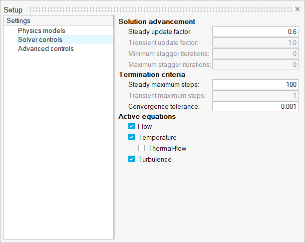

- Click the Solver controls setting.
Verify the following parameters.
Figure 7.

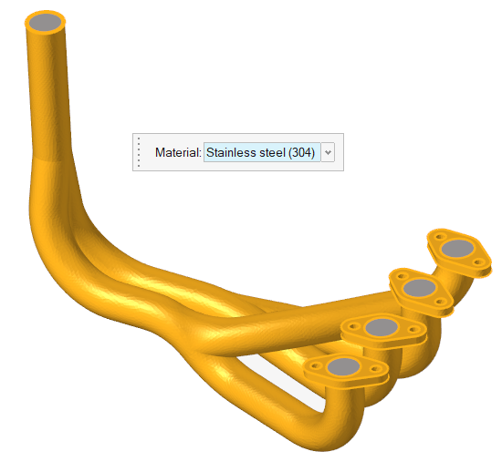

- Select the exhaust volume.
In the microdialog, select Stainless steel
(304) from the drop-down.
Figure 9.

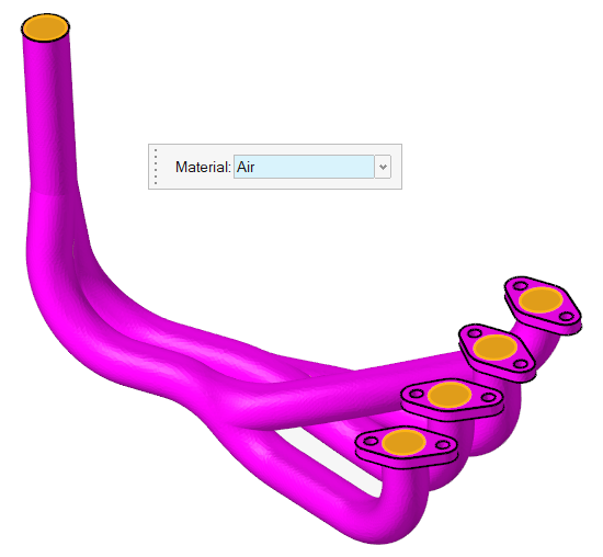

- Select the air volume.
In the microdialog, select Air
from the drop-down.
Figure 10.

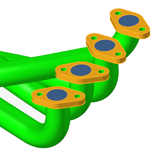

Select the manifold inlets highlighted in the figure below.
Figure 12.

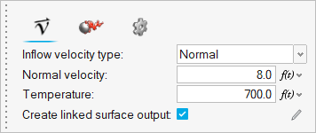

In the microdialog, set the Inflow velocity type to
Normal, the Normal velocity to
8.0 and the Temperature to
700.

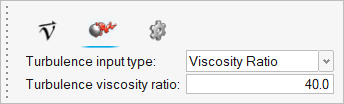

Figure 13.
Click the Turbulence tab in the microdialog. Set the input type to Viscosity
Ratio and the viscosity ratio value to
40.

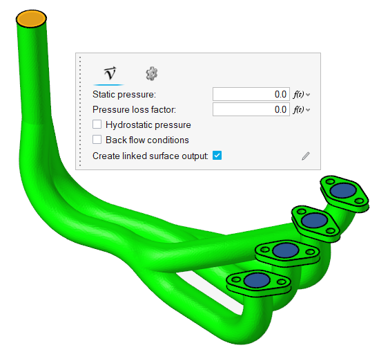

Click the Outlet tool.
Figure 15.
Select the face highlighted in the figure below and verify that both the static
pressure and the pressure loss factor are set to 0.
Figure 16.
Click
on the guide bar.

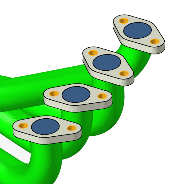

Select the wall flanges.
Figure 18.
Note: Make sure you select the bottom and side surfaces of the flanges. In total, 12 surfaces should be selected. -

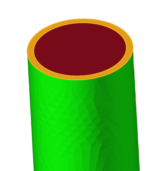

Hide all previously assigned surfaces then select the remaining surface.
Figure 23.

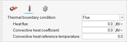

Check that default values are assigned to the thermal boundary
conditions.

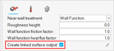

Link Surface Output
- In the Boundaries legend, right-click on Flanges and select Edit.
In the microdialog, activate the checkbox for
Create linked surface output.
Figure 25.
Click
to edit the values.

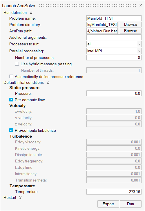

Figure 27.
- Set the Parallel processing option to Intel MPI.
- Deactivate the Automatically define pressure reference option.
- Expand Default initial conditions and check that the Pre-compute flow and Pre-compute turbulence options are activated.
- Set the Temperature to 273.16.
Leave the remaining options as default and click
Run to launch AcuSolve.

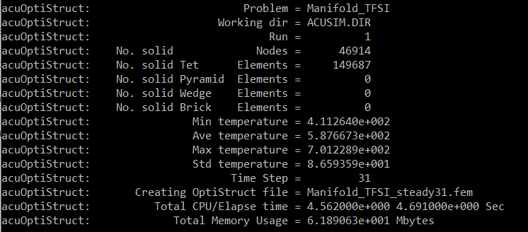

Run acuOptiStruct
- After AcuSolve finishes running, open the AcuSolve command prompt and cd to your working directory.
Execute the following command:
acuOptiStruct -solids “Exhaust Steel” -spcsurfs “Flange_Bolts – Output”,”Outlet_End – Output” -spcsurfsdof 123456,123456 -spcsurfsdofvals 0,0 -type sl
You should see a similar output as below when the command executes successfully.Figure 29.

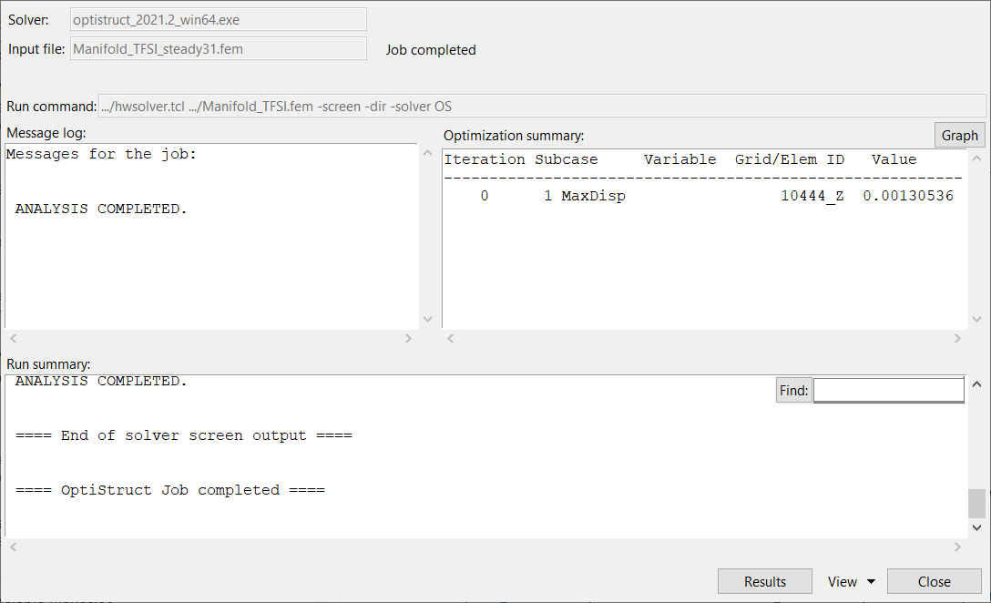

Run OptiStruct

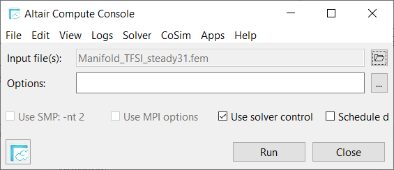

- Start OptiStruct from the Windows Start menu by clicking .
Click
next to Input file(s).
- Browse to the location that you are using as your working directory.
Select the .fem file.
Figure 30.
Click Run to run the case.

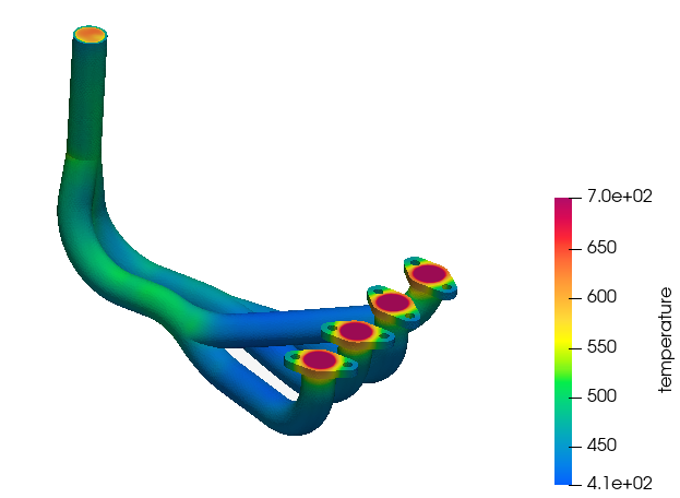

Post-Process the Results with HM-CFD Post
- Once the solution is completed, navigate to the Post ribbon.
- From the menu bar, click .
Select the AcuSolve log file in your problem
directory to load the results for post-processing.
The solid and all the surfaces are loaded in the Post Browser.
Click the Boundary Groups tool.
Figure 32.
- Select all the surfaces.
- In the microdialog, set the display to temperature and activate the Legend toggle.
Click
and set the Colormap name to Rainbow
Uniform.
Figure 33.
Click
on the guide bar.
Figure 34.
- In the Post Browser right-click on Fluid_Walls and select Edit.

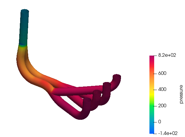

- In the microdialog, change the display to pressure and activate the Legend toggle.
Click
Uniform.
Figure 35.

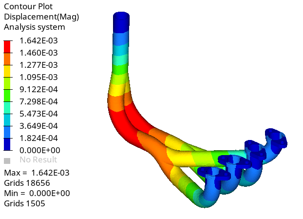

Click
on the Results toolbar to open the Contour panel.
- In the panel area, set the Result type to Displacement (v).
Click Apply to plot the displacement magnitude
contours.
Figure 37.

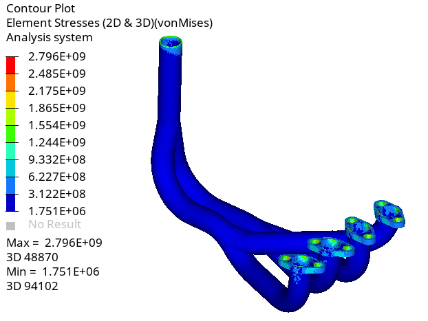

- Change the Result type to Element Stresses (2D & 3D) (t) and select vonMises from the drop-down below.
Click Apply.
Figure 38.
