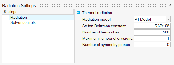

The Radiation Settings dialog opens. -
Activate the Thermal radiation checkbox and set the
Radiation model to P1 Model.
Figure 14.

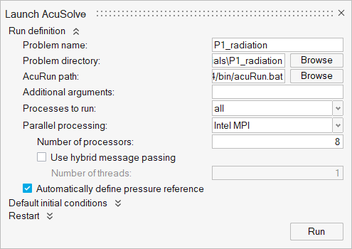

Run AcuSolve
Figure 23.
- Set the Parallel processing option to Intel MPI.
Leave the remaining options as default and click
Run to launch AcuSolve.
