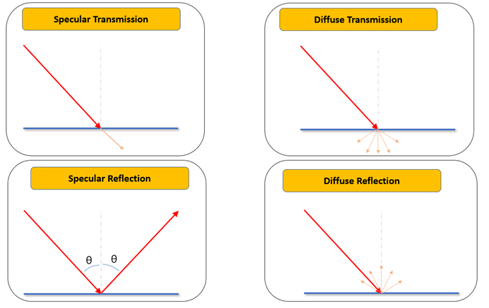

A specular transmission occurs when a photon passes straight through a surface with no change of direction. In a diffuse transmission the photon penetrates the surface, but its outgoing energy is uniformly distributed in solid angle over the hemisphere, weighted by projected surface area. For a specular reflection, the angle of reflection is equal to the angle of incidence. Diffuse reflections are similar to diffuse transmissions, except the hemisphere over which the outgoing energy is distributed is on the same side of the surface as the incident photon. Finally, the photon may be absorbed by the surface. These five interactions are associated with five surface properties that together must obey the following constraint:
- Specular transmissivity
- Diffuse transmissivity
- Specular reflectivity
- Diffuse reflectivity
- Absorptivity
- Angle of incidence

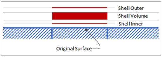

When defining a thermal shell on a surface, two sets of boundary conditions are needed. One for the Primary Wall surface i.e. Shell Inner and one for the Shell Outer Wall surface. In this tutorial, a solar radiation surface will be defined on the outer shell surface so that it receives solar heat flux, whereas the inner shell surface will be modeled as a default wall.

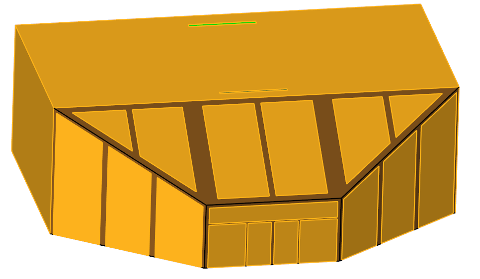

Import and Validate the Geometry
Import the Geometry
- From the menu bar, click .
- In the Import File dialog, browse to your working directory then select ACU-T3201_Atrium.x_t and click Open.
In the Geometry Import Options dialog, leave all the
default options unchanged then click Import.
Figure 5.
Figure 6.

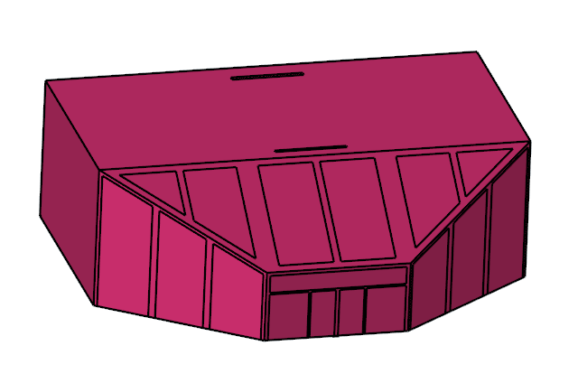

The model contains an atrium with glass panes supported by an aluminum frame in the front. Air enters from the opening on the roof in the front and exits through the outlet in the rear.

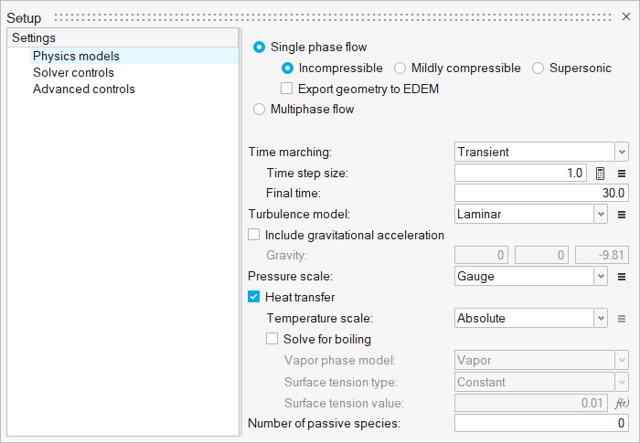

The Setup dialog opens. -
Under the Physics models setting:
- Set Time marching to Transient.
- Set the Time step size to 1 and the Final time to 30.
- Set the Turbulence model to Laminar.
- Activate the Heat transfer checkbox.
Figure 10.

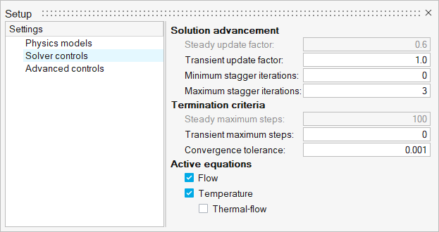

Click the Solver controls setting and set the Maximum
stagger iterations to 3.
Figure 11.
- Close the dialog and save the model.

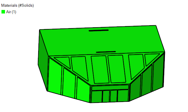

Verify that Air is assigned as the material for the fluid domain.
The legend in the top-left corner of the modeling window lists all the material models assigned to the current model.Since this model has a single volume, by default air is assigned as the material for the fluid domain.

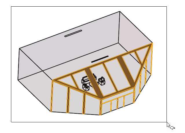

Define Thin Solids

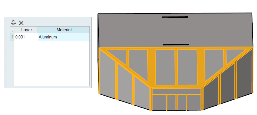

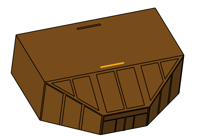

In this simulation, you will model the aluminum frames as a thin solid.
From the Flow ribbon, click the Thin tool.
Figure 14.

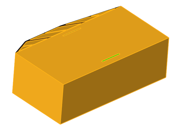

In the modeling window, select the four surfaces
highlighted in the image below.
Figure 15.
- In the microdialog, set the Layer thickness to 0.025 and the Material to Aluminum.
On the guide bar, verify that the number of Parent
Surfaces selected is 4 then click
to execute the
command.
Once the command is executed, the legend should be updated accordingly to reflect the changes. - Save the model.

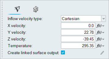

From the Flow ribbon, click the Constant tool.
Figure 16.
In the modeling window, click the inlet surface
highlighted in the figure below.
Figure 17.
In the microdialog, enter the values shown below.
Figure 18.
Click
on the guide bar to execute
the changes.

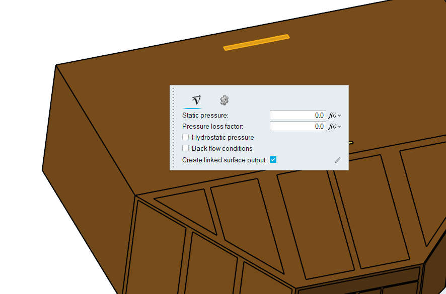

Click the Outlet tool.
Figure 19.
Select the surface highlighted in the figure below then click
on the guide bar.

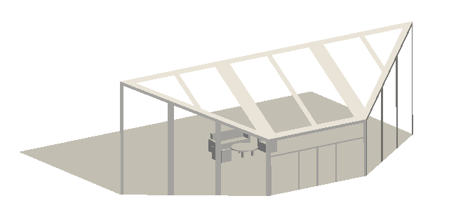

From the Boundaries legend, right-click on Default Wall
and select Isolate.
Figure 28.
Select all the surfaces except the aluminum frame, as highlighted in the figure
below.
Figure 29.

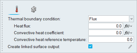

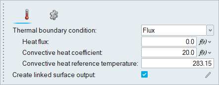

In the microdialog, enter the values shown in the
figure below.
Figure 30.
Click
. In the
new microdialog that appears, set the Nodal Output
frequency to 1.
- From the Boundaries legend, rename Wall 1 to Floor by double-clicking on it.
Click
on the guide bar.
The updated Boundaries legend should look similar to the one shown below.Figure 31.

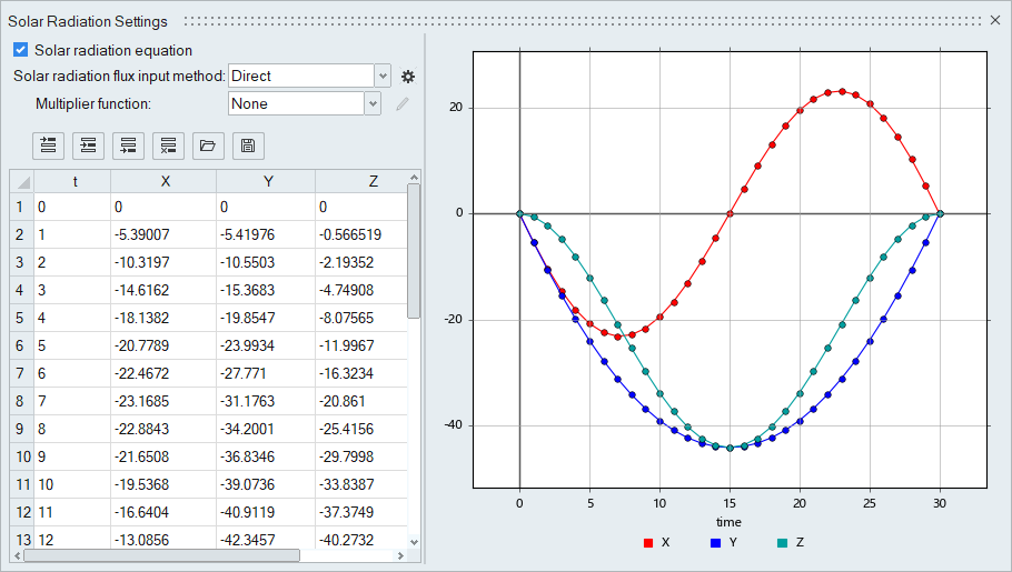

- In the Solar Radiation Settings dialog, activate the Solar radiation equation.
Click
to load
the solar flux input from a file.
- In the Open file dialog, set the filter to Dat file (.dat) and select the SolarLoad.dat file provided with the input file for this tutorial.
Click Open.
The plot in the dialog should look like the one shown in the figure below.
Figure 33.

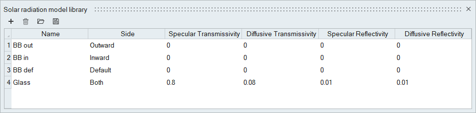

In the Solar radiation model library, click
to add a new
solar radiation model.
- In the Name column, enter BB out and set the Side to Outward.
Similarly, create the other models and enter the values as shown in the figure
below.
Figure 35.

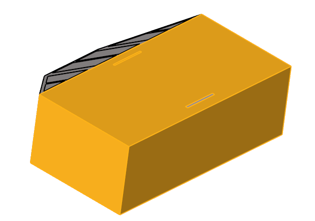

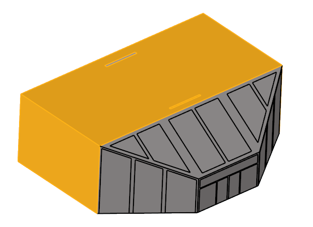

Select the three wall surfaces, the inlet, and the roof surface, as highlighted
in the figures below.
Figure 37. Front-Side of the Model
Figure 38. Back-Side of the Model
In the microdialog, set the Solar radiation model to
BB out then click
on the guide bar.

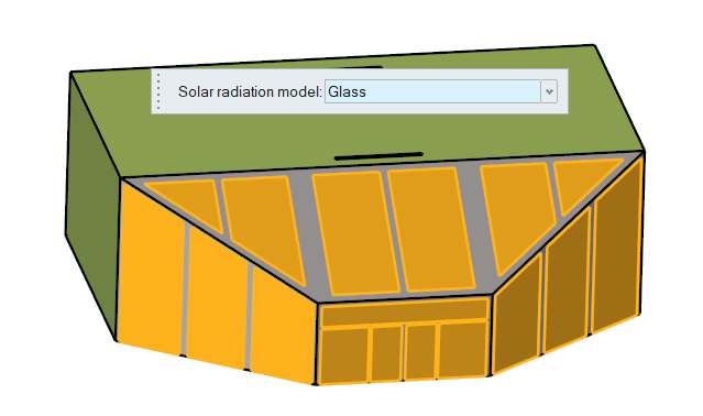

Select all the glass surfaces shown in the figure below, assign the
Glass model to them, then click
on the guide bar.

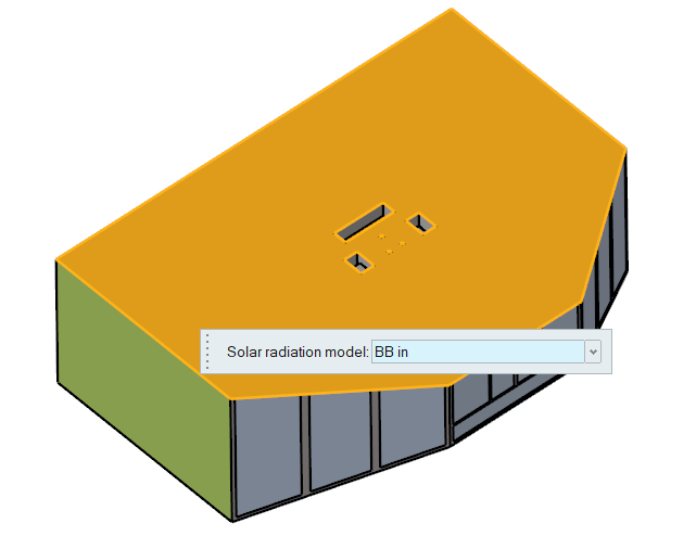

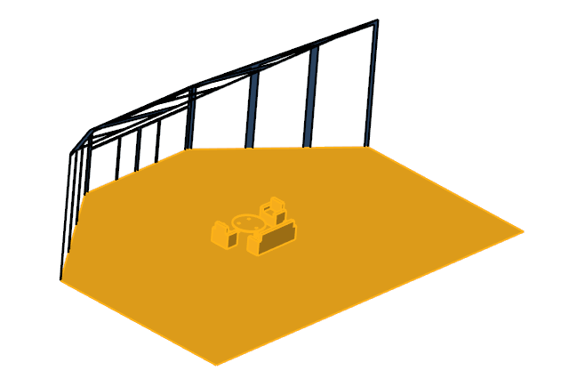

Rotate the model and select the floor surface. In the microdialog, assign the BB in model
then click
on the guide bar.

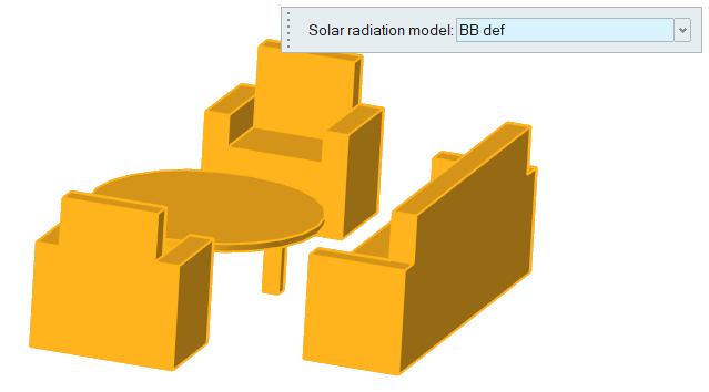

- From the Solar Radiation Model legend, right-click on Unassigned and select Isolate.
Select the surfaces of the couch, table, and chairs, assign the BB
def model to them, then click
on the guide bar.

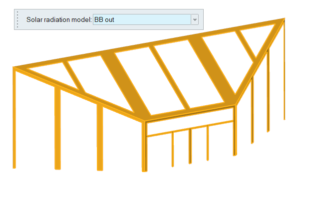

- On the guide bar, change the selection entity to Thin Solids.
Using the window selection method, select the four thin solid surfaces and
assign the BB out model to them.
Figure 42.
On the guide bar, verify that the Direction is set to
Away from Parent Surface then click
to execute
the changes.

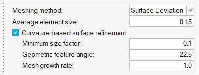

In the microdialog, set the Average element size to
0.15 and the Mesh growth rate to
1.0.
Figure 44.

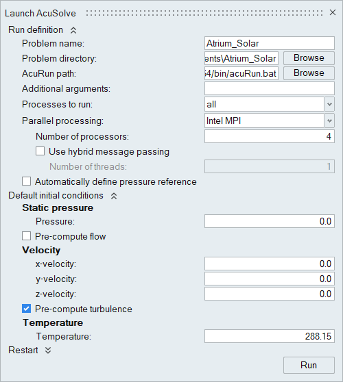

Figure 48.
- In the Launch AcuSolve dialog, set the Parallel processing option to Intel MPI.
- Deactivate the Automatically define pressure reference option.
- Expand the Default initial conditions menu.
- Deactivate the Pre-compute flow option.
- Set the Temperature to 288.15.
Verify that all the values are set as shown in the figure below.
Figure 49.
Click Run.

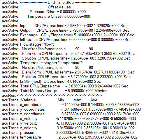

Once the run is complete, a summary of the solution process is shown in the log file.
Figure 50.

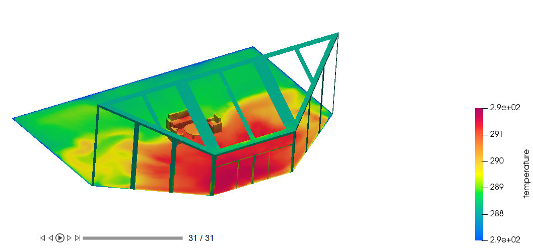

Post-Process the Results with HM-CFD Post
Create Surface Groups
- Once the solution is completed, navigate to the Post ribbon.
Select the AcuSolve log file in your problem
directory to load the results for post-processing.

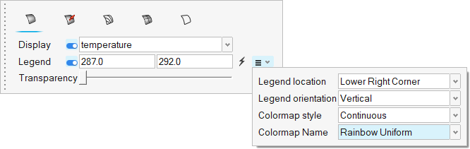

Plot the Temperature Contour
- In the Post Browser, right-click on the ThinSolid_Floor surface group and select Edit.
- In the display properties microdialog, set the display to temperature and activate the Legend toggle.
- Set the legend bounds to 287 and 292.
Click
and set the Colormap Name to Rainbow
Uniform.
Figure 54.
Click
on the guide bar.
Drag the animation slider at the bottom of the modeling window to the 31st
frame.
Figure 55.
