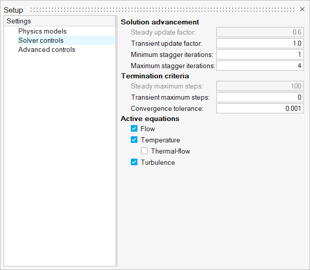

Under the Advanced controls setting, set the minimum stagger iterations to
1 and the maximum to 4.

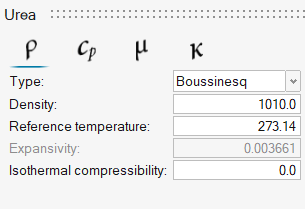

Name the material Urea, set the density (ρ) type to
Boussinesq and enter Density (kg/m3) and
Reference temperature (K) values as shown below.
Figure 9.

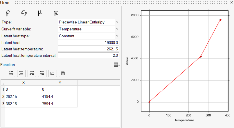

- Click the Specific Heat tab and set the Type to Piecewise Linear Enthalpy.
- Verify that the Curve fit variable is set to Temperature.
- Set the Latent heat type to Constant.
- Enter the values for Latent heat (J), Latent heat temperature (K), and Latent heat temperature interval (K) by referring to the figure below.
Click
three times to add three rows to the table and then
enter the table values according to the figure below.
Figure 10.

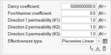

Assign the Porous Media values according to the following figure.
Figure 14.

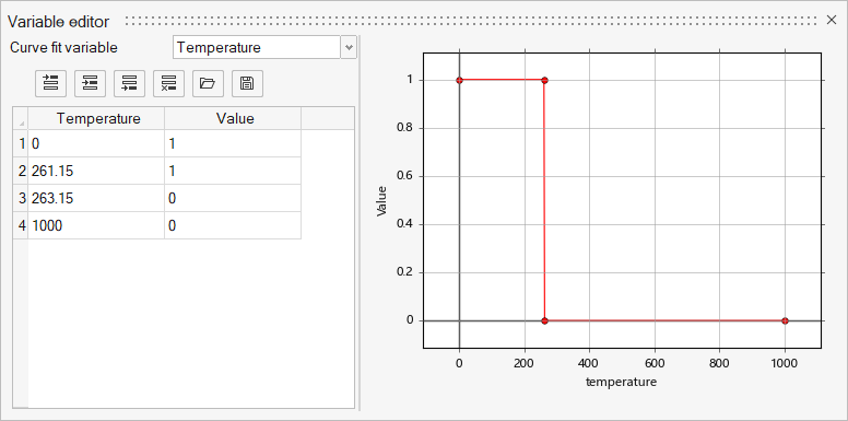

Click
besides Effectiveness type.
In the new dialog, click
four time to add four empty rows to the table then
enter values according to the figure below.
Figure 15.

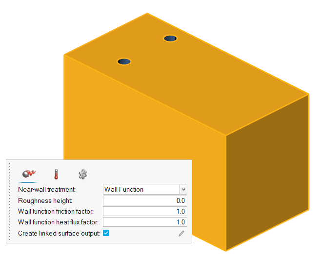

From the Flow ribbon, click the No Slip tool.
Figure 16.
Select the exterior faces of the plastic tank.
Figure 17.

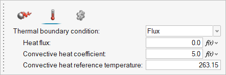

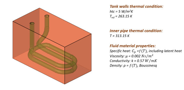

- In the microdialog, click the Temperature tab.
- Verify that the Thermal boundary condition is set to Flux.
- Set the Convective heat coefficient to 5.0 W/m2K.
Set the Convective heat reference temperature to 263.15
K.
Figure 18.
Rename the wall boundary.
- Double-click on Wall in the legend on the left side of the modeling window.
- Type Exterior_Wall and press Enter.

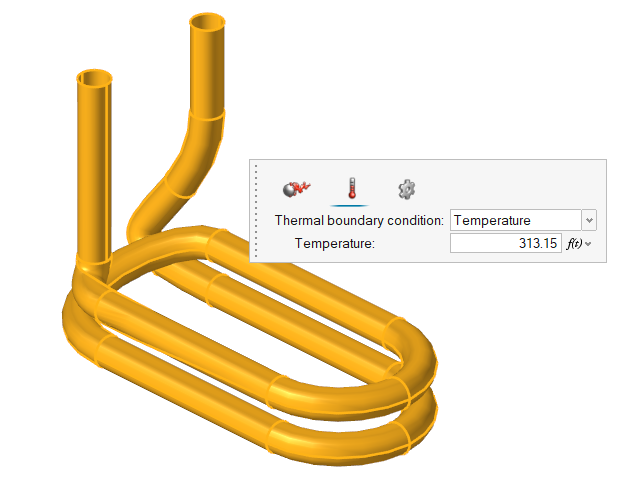

- Hide Exterior_Wall and select the interior faces of the heating element.
Change the Thermal boundary condition to Temperature and
set the Temperature (K) to 313.15.
Figure 19.
- Double-click on Wall in the legend and rename it to Pipe.

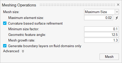

Set the Maximum element size (m) to 0.02 and verify the
geometric feature angle (degree) is set to 12.5.
Figure 21.
Click Mesh.

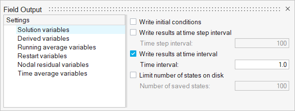

Set the Field Outputs
Form the Solution ribbon, click the Field tool.
Figure 22.
- Uncheck Write results at time step interval.
- Check Write results at time interval.
Set the Time interval to 1 sec.
Figure 23.

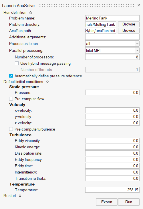

Run AcuSolve
Figure 24.
The Launch AcuSolve dialog opens. - Set the Parallel processing option to Intel MPI.
Set the Default initial conditions as in the following figure.
Figure 25.
- Leave the remaining default options then click Run to launch AcuSolve.

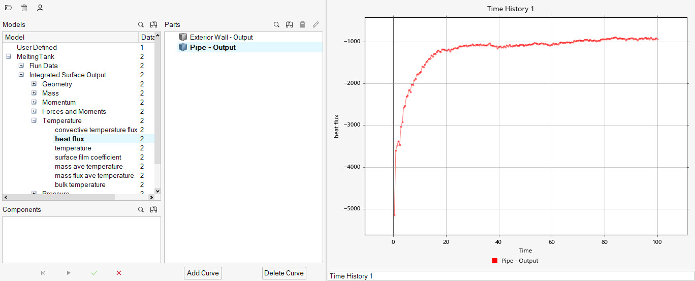

From the Solution ribbon, click the Manage tool.
Figure 26.

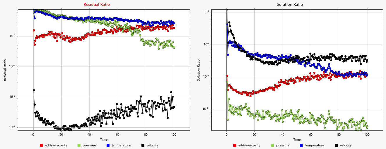

In the Run Status dialog, right-click on the AcuSolve run and select Plot time
history to launch the Plot Manager.
The residual and solution ratios for pressure, velocity, eddy viscosity, and temperature are shown.
Figure 27.
Click
to define a new plot.
- Expand and select heat flux.
Select Pipe – Output to plot the heat flux entering the
domain from the heating element.
Note: The value stabilizes near the end of the simulation, indicating that the model is approaching the prescribed thermal boundary conditions.
Figure 28. Integrated heat flux entering the domain from the heating element surface

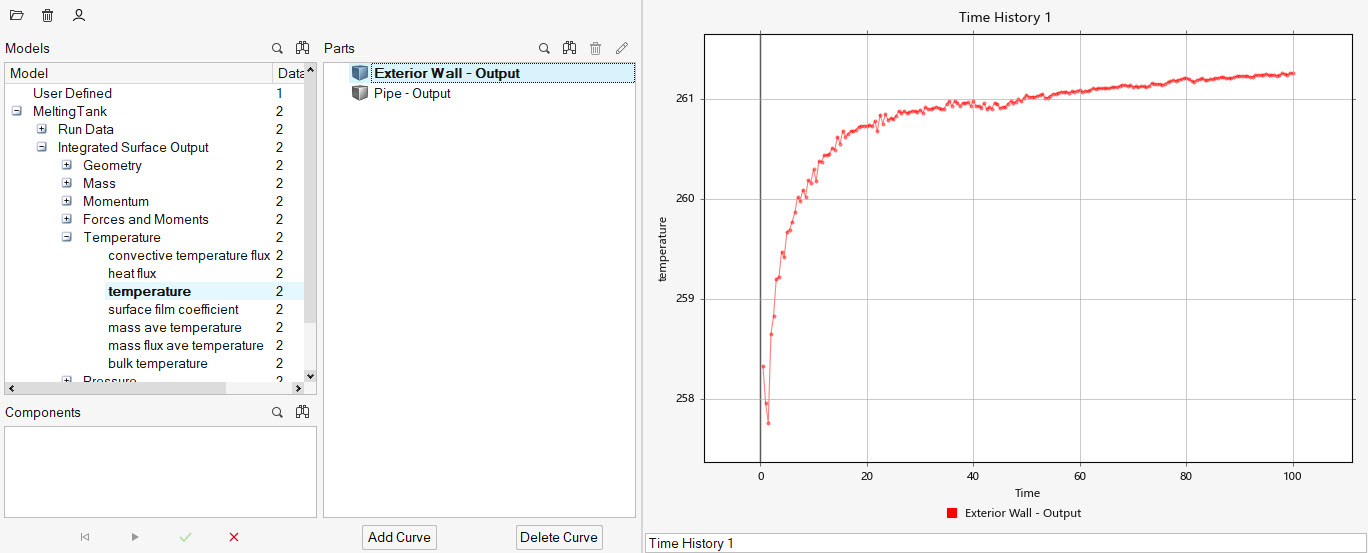

- Expand the .
Select the Exterior Wall – Output to plot the
temperature increase of the inside wall of the tank.
Note: The value is not stabilized by the end of the simulation, indicating that the model has not reached the final temperature to balance the prescribed thermal boundary conditions.
Figure 29. Integrated temperature on the interior surface of the tank wall

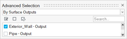

Select Exterior_Wall - Output then close the
dialog.

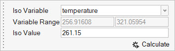

Select temperature as the Iso Variable and set the Iso
Value of temperature (K) to 261.15.
Figure 33.
- Click Calculate.

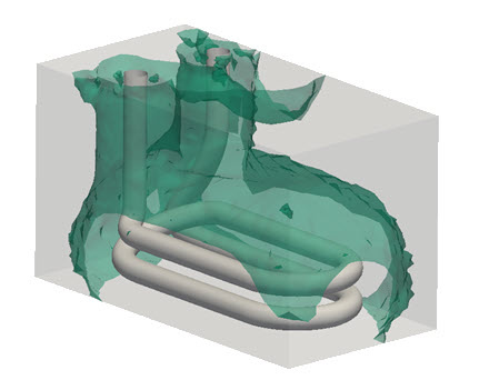

Figure 34. Transparent boundary of the tank, showing an Iso-Surface of temperature T=261.15 K, Time=0.0 sec
