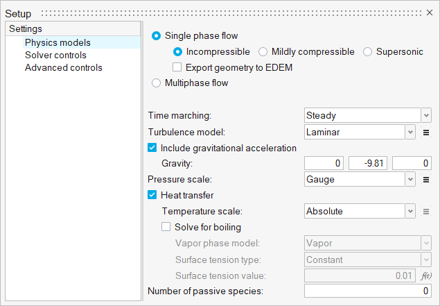

Set Up Flow
Figure 11.
The Setup dialog opens. -
Under the Physics models setting:
- Verify that Time marching is set to Steady.
- Select Laminar as the Turbulence model.
- Activate the Include gravitational acceleration checkbox and set the gravity in the y direction to -9.81.
- Activate the Heat transfer checkbox.
Figure 12.

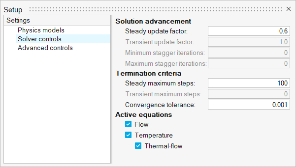

Click the Solver controls setting and activate the
Thermal flow equation.
Figure 13.

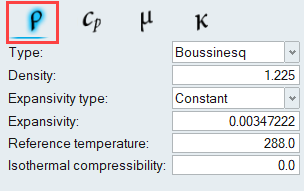

In the Density tab,
- Set the Type to Boussinesq.
- Set the Density value to 1.225.
- Set the Expansivity value to 0.00347222.
- Reference temperature value to 288.
Figure 15.

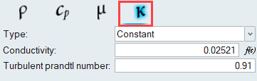

Click the Conductivity tab and set the Conductivity
value to 0.02521.
Figure 18.

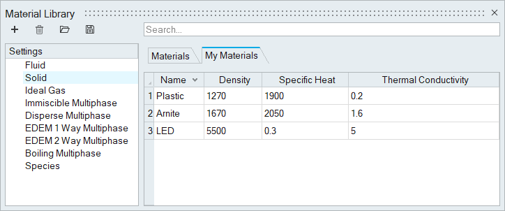

Select Solid in the Settings menu, click the
My Materials tab, then click
to create a new
solid material model.
Name the material Plastic and set the following
values.
The Type should be Constant for each property.
- Density: 1270
- Specific Heat: 1900
- Conductivity: 0.2
- Close the material creation dialog to return to the Material Library dialog.
Similarly, create new solid material models named Arnite
and LED with the following properties.
The Type should be Constant for each property.Arnite:
- Density: 1670
- Specific Heat: 2050
- Conductivity: 1.6
LED:- Density: 5500
- Specific Heat: 0.3
- Conductivity: 5.0

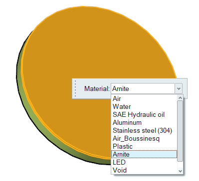

Click the lens volume highlighted in the figure below and select
Arnite from the Material drop-down menu.
Figure 21.

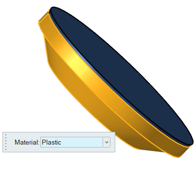

Click the housing volume and assign the Plastic material
model.
Figure 22.

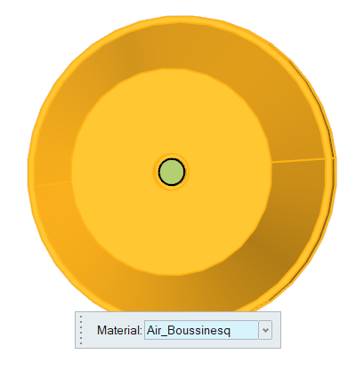

Click the air volume and assign the Air_Boussinesq
material model.
Figure 23.
On the guide bar, click
to execute the command and remain in the
tool.

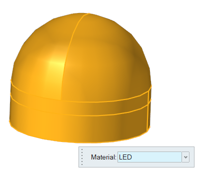

Click the bulb volume and assign the LED material
model.
Figure 24.
to execute

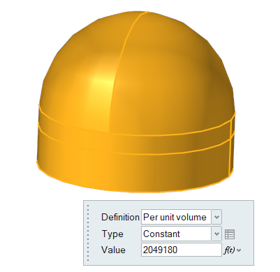

Define the Heat Source
From the Flow ribbon, click the tool.
Figure 25.
- In the modeling window, select the bulb volume.
In the Heat Source dialog, set the heat source value to
2049180 W/m3.
Figure 26.
to execute
- Press Esc to exit the Sources tool then press the A key to turn on the display of all solids.

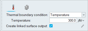

In this problem, all the surfaces are walls and will therefore be assigned the default wall boundary condition. The outer walls of the headlamp will be given a no-slip wall boundary condition with a constant temperature.
From the Flow ribbon, click the No Slip tool.
Figure 27.
In the modeling window, select the surfaces highlighted
in the figure below.
Figure 28.
In the microdialog, enter the values shown in the
figure below.
Figure 29.
- In the Boundaries legend, double-click Wall, rename it to Outerwalls, then press Enter.
to execute
- Save the model.

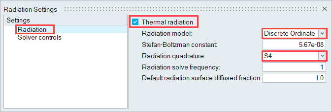

Define Radiation Model Settings
From the Radiation ribbon, Thermal Radiation tools, click the Physics tool.
Figure 30.
The Radiation Settings dialog opens. - Activate Thermal radiation and set the Radiation model to Discrete Ordinate.
Verify that the Radiation quadrature is set to S4.
Figure 31.
- Close the dialog.

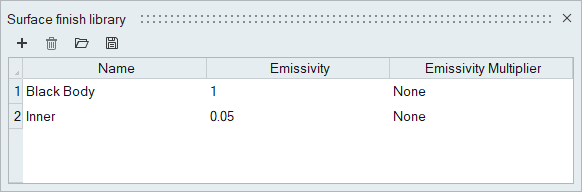

Define the Emissivity Models
From the Radiation ribbon, click the
Surface Finish Library
tool.
Figure 32.
The Surface finish library opens.Click
to add a
new emissivity model. -
Set the Name of the model to Inner and the Emissivity
value to 0.05 by double-clicking on the entity
fields.
Figure 33.
- Close the dialog.

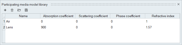

Define the Participating Media Radiation Models
From the Radiation ribbon, Participating Media tools, click the Model tool.
Figure 34.
The Participating media model library opens. -
Click
to add a
new model.
Name the new model Air and assign the following property
values:
- Absorption coefficient - 0
- Scattering coefficient - 0
- Phase coefficient - 0
- Refractive index - 1
Similarly, create another model named Lens and assign
the following property values:
- Absorption coefficient - 900
- Refractive index - 1.57
Figure 35.
- Close the dialog.

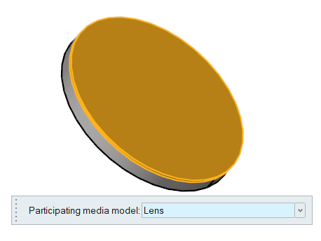

Click the lens volume and assign the Lens model from the
microdialog drop-down.
Figure 37.
tool.

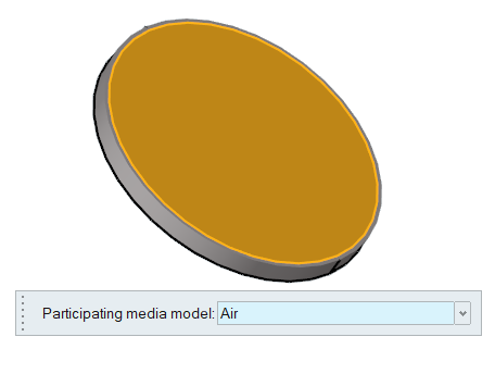

Select the air volume and assign the Air model.
Figure 38.
tool.
- In the Participating Media legend, right-click on Air and select Hide.

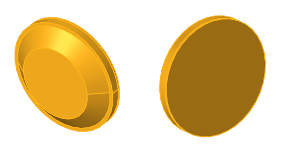

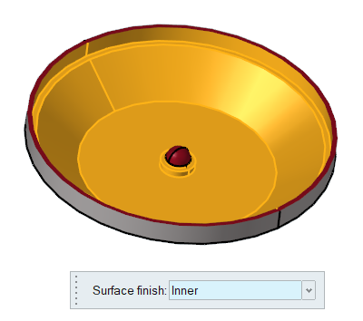

Select only the inner surfaces of the housing - i.e. the housing-air
interface.
Figure 40.
A total of nine surfaces should be selected.
- Assign the Inner model from the microdialog drop-down
to execute

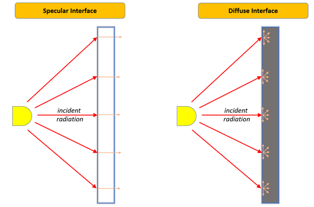

Define the Radiation Interfaces
Since the lens and air are defined as semi-transparent media, the interface between the two will be modeled as a specular interface of type: internal. Accordingly, the outer surfaces of the lens will be modeled as external interface radiation surface.
Interface tool.
Figure 41.

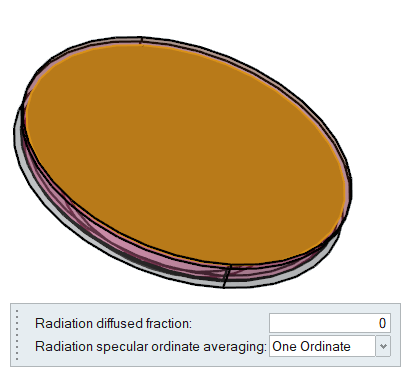

Notice that all the surfaces except the Lens-Air interface surface are made transparent. Since the Air and Lens volumes are defined as participating media, HyperMesh CFD automatically detects the surfaces that can be defined as an internal radiation interface and only those surfaces will be available for selection when this tool is active. -
Using the box selection method, draw a window around the model.
Observe that the lens-air interface is the only surface that is selected.
In the microdialog, set the Radiation diffused fraction
to 0.
Figure 42.
to execute

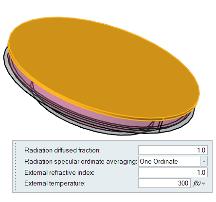

Click the External Boundary tool.
Figure 43.
- Select the three outer surfaces of the lens volume.
to 1, the External refractive index to
1, and the External temperature to
300 K.
Figure 44.
to execute

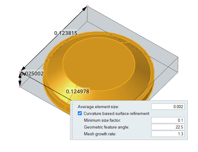

Define the Surface Mesh Controls
From the Mesh ribbon, click the Surface tool.
Figure 45.
- Using the box selection method, select all the surfaces in the model.
In the microdialog, set the Average element size to
0.002.
Figure 46.
tool.

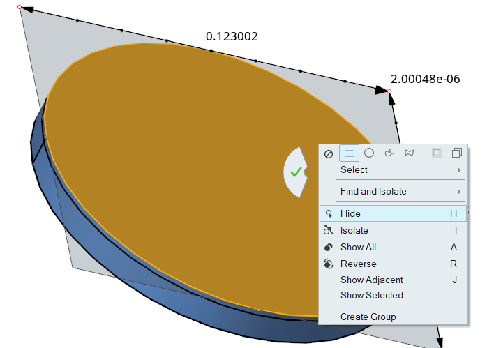

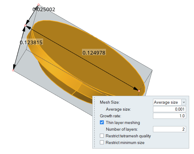

Select the surface highlighted in the figure below and hide it by pressing the
H key or by right-clicking and select
Hide from the context menu.
Figure 47.

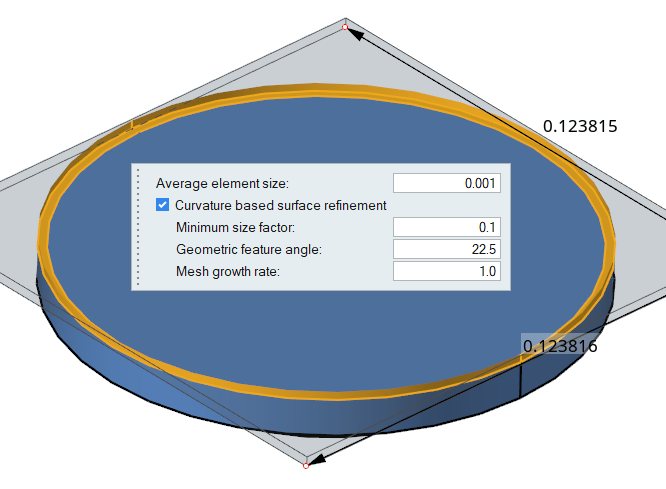

- Select the three surfaces highlighted in the figure below.
0.001 and the Mesh growth rate to
1.
Figure 48.
to execute

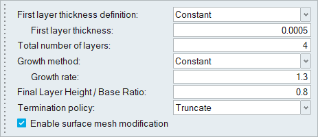

Define the Boundary Layer Controls
From the Mesh ribbon, click the Boundary Layer tool.
Figure 49.
Right-click in the modeling window and go to .
All the fluid wall surfaces should be selected and a microdialog for BL specification appears.
Enter the following values in the microdialog:
- First layer thickness definition: Constant
- First layer thickness: 0.0005
- Total number of layers: 4
- Growth method: Constant
- Initial growth rate: 1.3
- Termination policy: Truncate
- Activate the Enable surface mesh modification option
Figure 50.
to execute

Define the Volume Mesh Controls
Since the thickness of the housing and the lens solids are small, you will use the thin layer meshing tool so that when the volume mesh is generated, there will be two layers across the thickness of those solids.
From the Mesh ribbon, click the Volume Mesh tool.
Figure 51.
- Select the housing and the lens solids.
In the microdialog,
- Set the Average size to 0.001.
- Set the Growth rate to 1.0.
- Activate the Thin layer meshing option and set the Number of layers to 2.
Figure 52.
to execute
Generate the Mesh
Volume tool.
Figure 53.
The Meshing Operations dialog opens. - Set the Mesh growth rate to 1.
Click Mesh.
The Run Status dialog opens. Once the run is complete, the status is updated and you can close the dialog.Tip: Right-click on the mesh job and select View log file to view a summary of the meshing process.
- Save the model.

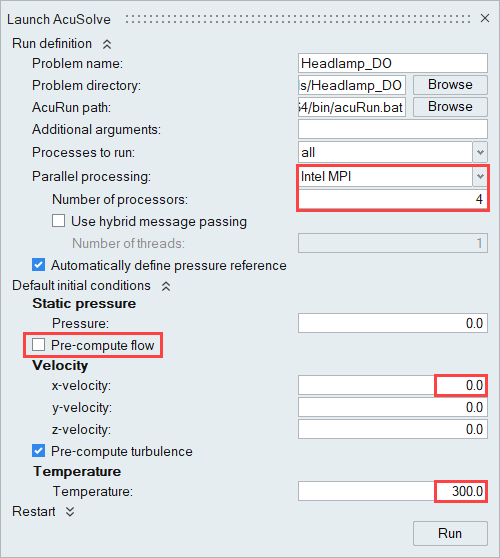

Run AcuSolve
Figure 54.
The Launch AcuSolve dialog opens. - Set the Parallel processing option to Intel MPI.
- Expand the Default initial conditions menu and deactivate the Pre-compute flow option.
- Set the x-velocity to 0 and the Temperature to 300.
Leave the remaining options as default and click
Run to launch AcuSolve.
Figure 55.

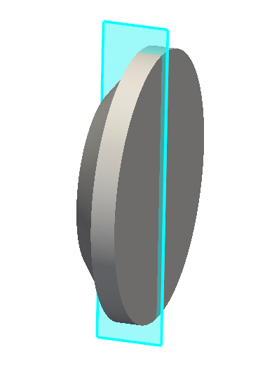

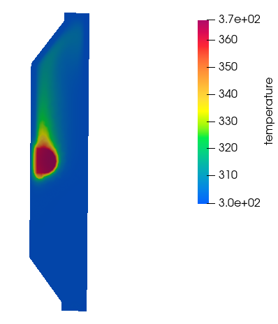

Click the Slice Planes tool.
Figure 56.
Select the plane perpendicular to the x-axis, as shown in the figure
below.
Figure 57.
Click the Front face on the View Cube to align the
model.
Figure 58.
Click
in the slice plane microdialog.

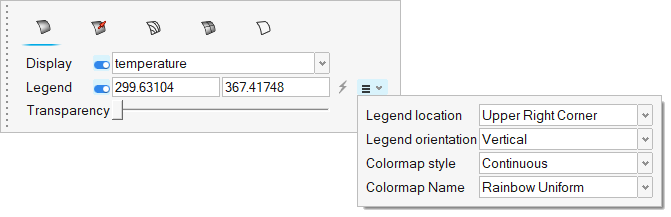

- In the display properties microdialog, set the display to temperature.
Activate the Legend toggle and click
to reset the range.
Click
, set the Legend location to Upper Right
Corner, and the Colormap Name to Rainbow
Uniform.
Figure 59.
Click
on the guide bar.
In the Post Browser, hide the Boundary
Collections.
Figure 60.

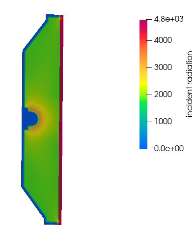

- Right-click on Slice Plane 1 in the browser and select Edit.
- Change the display to incident radiation.
Click
to refresh the legend's range.
Click
on the guide bar.
