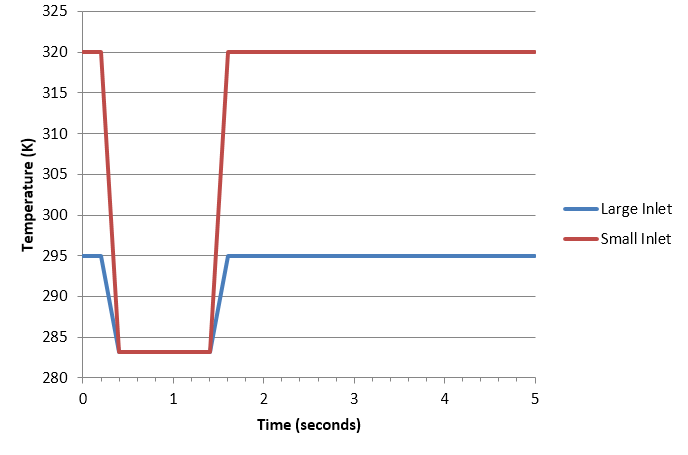

At 0.2s into the simulation, a cold slug of water is injected at both the inlets and the temperature is ramped down to 283.15 K starting from 0.2 s to 0.4 s. Then it is maintained constant at 283.15 K for 1 sec and then ramped up to initial states from 1.4s to 1.6s. Given a flow path of 0.6356 m, the transit time for the slug is approximately 1.6s. Therefore, our simulation time should be at least 3.2 s to factor in the duration of the slug and transit time. The total simulation time will be 4.5s to allow time for the thermal conditions to return to a steady state.
The temperature change at the large inlet is from 295 K to 283.15 K. At the small inlet, the temperature changes from 320 K to 283.15 K. The ratio of the cold slug temperature to the initial temperature of the large inlet flow is 0.9598. The ratio of the cold slug temperature to the initial temperature of the small inlet flow is 0.8848. These values will be used in creating multiplier functions to model the transient temperatures at the inlets.

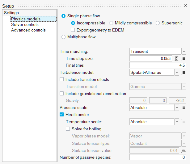

Under the Physics models setting:
- Set Time marching to Transient.
- Set the Time step size to 0.053 and the Final time to 4.5.

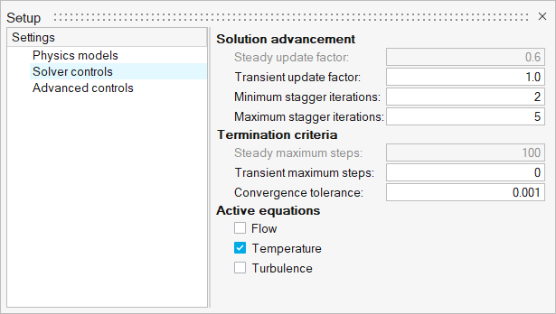

- Click the Solver controls setting.
- Set the Minimum and Maximum stagger iterations to 2 and 5, respectively.
De-activate the Flow and
Turbulence equations.
By turning these options off, AcuSolve will not update the solution to these equations. Instead, the current flow and turbulence values (generated from the steady state solution for this tutorial) will be used throughout the simulation, and AcuSolve will only solve for the temperature field.

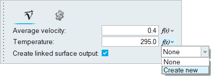

In the microdialog, click multiplier function drop-down
menu next to Temperature and select Create new.
Figure 13.

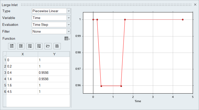

In the dialog that appears, edit the name of the multiplier function by
clicking
in the
top-left corner. Set the name to Large Inlet.
- Set the Type to Piecewise Linear.
- Verify that the Variable is set to Time and Evaluation is set to Time Step.
Click
four times
to add four new rows to the bottom of the table.
Enter the table values for the multiplier function as shown in the image
below.
Figure 14.
- Close the dialog.

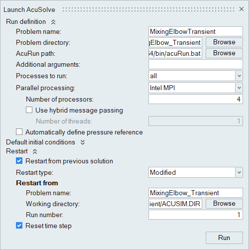

Launch AcuSolve
Figure 18.
The Launch AcuSolve dialog opens. - Set the Parallel processing option to Intel MPI.
- Deactivate the Automatically define pressure reference option.
- Expand the Restart menu and activate the Restart from previous solution option.
- Set the Problem name to MixingElbow_Transient (if not set already).
- Verify that the Run number is set to 1 and the Reset time step option is activated.
Click Run to start the transient run.

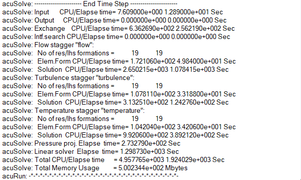

Figure 19.
- In the Run Status dialog, right-click on the second AcuSolve run and select View log file.
- Once the solver run is complete, close the Run Status dialog.

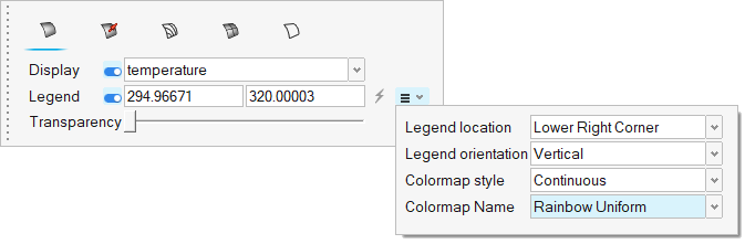

- In the display properties microdialog, set the display to temperature.
Activate the Legend toggle and click
to reset the range.
Click
and set the Colormap Name to Rainbow
Uniform.

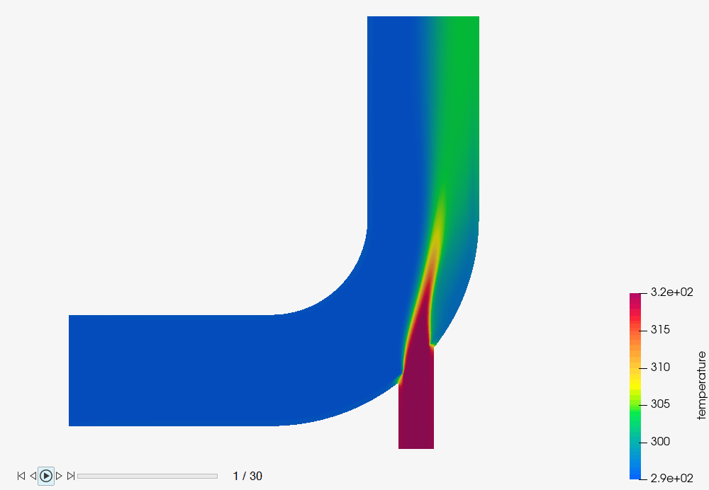

Click
at the bottom of the modeling window to view an animation of the transient flow
with respect to the temperature contour.
