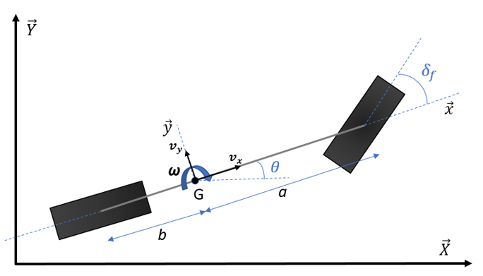

The well-known bicycle model is used as a first approximation to represent a multi-wheeled road vehicle.
There are two control models for the Steering control.- Kinematic bicycle model
- Dynamic bicycle model
- Kinematic Bicycle Model
In Kinematic bicycle model, the equations of motion are based purely on geometric relationships governing the system. The major assumption used in the development of the kinematic model is that the velocity vectors at points A and B are in the direction of the orientation of the front and rear wheels respectively. This is equivalent to assuming that the "slip angles" at both wheels are zero. This is a reasonable assumption for low speed motion of the vehicle (for speeds less than 5 m/s). This model does not consider the vehicle’s dynamics such as slipping and skidding.
The kinematic equations of the bicycle model are written in terms of coordinates of the vehicle which gives our three degrees of freedom non-linear model
.The equations on motion written as a set of three differential equations where the state vector is:
The quantities are:
- Vehicle Yaw Angle
- Lateral Displacement of the vehicle
- Longitudinal Displacement of the vehicle
Equations of motion can be written as:
where,
- Velocity of the vehicle
- Rear axle to CG distance
- Slip angle at the center of gravity - Dynamic Bicycle Model
