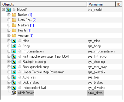

Driver Graphical User Interface
Click on the Altair driver analysis to bring up the Altair driver graphical
user interface.
The corresponding panel is displayed.Figure 2.

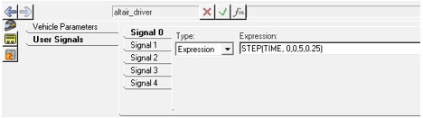

Define any MotionView signal that can be used in
the ADF as path profile, velocity profile, etc. in the User
Signals tab.

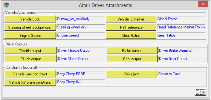

Click on the Attachments button to open the Altair
Driver Attachments dialog.
Figure 4.
Attachments Vehicle Body *Required
Vehicle body to calculate velocities, accelerations and position of the vehicle. Vehicle IC marker *Required
Marker with respect to whom the initial velocities are specified in the Altair driver file. Steering wheel revolute joint *Required
Steer joint of the vehicle used to lock the joint during static and define motion/torque on for steer controller outputs. Path reference *Required
Marker with respect to whom the user defined path, if any, is resolved. Engine Speed *Required (IC engine powertrain)
Solver variable from the powertrain system that gives engine speed. Present only if IC engine is selected for the model.
Resolved with the Dummy variable in powertrain system in case of linear torque map powertrain.
Gear Ratios *Required (IC engine powertrain)
Curve that informs driver about the gear ratios of the gear box if any. Present only if IC engine is selected for the model.
Resolved with the Dummy variable in a powertrain system in the case of a linear torque map powertrain.X(Gear) Y(Ratio) 0 0.00 (oth gear is ignored) 1 4.7 2 3 Throttle output *Required
Solver variable in vehicle model used by Altair driver to populate throttle output. Brake output *Required
Solver variable in vehicle model used by Altair driver to populate brake output. Clutch output *Required (IC engine powertrain)
Solver variable in vehicle model used by Altair driver to populate clutch output. Present only if IC engine is selected for the model.
In case it is not needed, if can be resolved to any unused solver variable.
Gear output *Required (IC engine powertrain)
Solver variable in vehicle model used by Altair driver to populate gear output. Present only if IC engine is selected for the model.
Vehicle yaw constraint *Optional
Perpendicular axes joint between vehicle body and the ground body. Used to constrain the vehicle from yawing while solving static.
The constraint is deactivated after solving Static.
Vehicle XY plane constraint *Optional
Inline joint between vehicle body and ground body. Aligning z axes of both ground and body. Used to constrain the vehicle from translating along XY plane while solving static.
Drive joint *Optional
Revolute joint between drive shaft and engine body fixed to the vehicle. Used to lock the differential while solving static.
