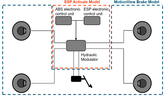

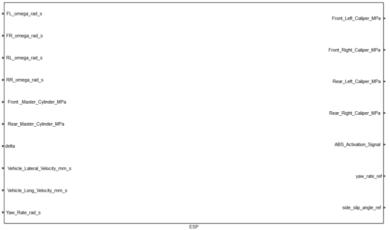

ESP Module in Twin Activate
Some of the inputs represent signals from sensors (wheels velocities, vehicle long and lateral velocity, steering angle, yaw rate) while the rest are connecting the hydraulics parts from MotionView to the ones in Twin Activate (Master cylinder pressure). Vehicle velocities are usually estimated rather than measured. In the current implementation these values were used as outputs from MBS vehicle model in order to focus on the control system’s behavior.

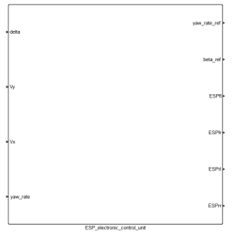

ESP Electronic Control Unit

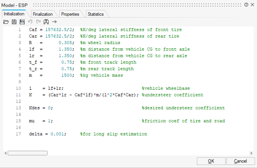

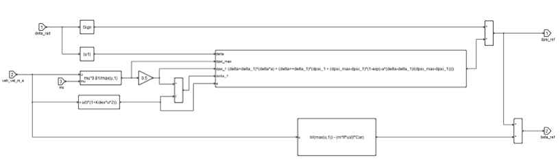

In Twin Activate equations (1) and (2) can be implemented as shown below:Figure 5. Yaw Rate and Side-Slip Angle Reference in Twin Activate
For the calculation of reference values, except from
and
signals
that come from MotionView, some parameters should also
be set in model initialization in Twin Activate as shown
below:Figure 6. ESP Parameters in Twin Activate

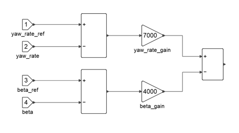

- Control Law
- As mentioned before, ESP uses the error of the yaw rate and the side-slip angle to
generate the desired yaw moment for the vehicle. Thus, the control law can be
represented as a Proportional controller as shown below:
Where
and
are the proportional gains of the controller.Figure 7. ESP Control Law in Twin Activate

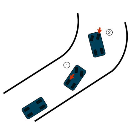

As stated earlier, ESP’s actuator is the vehicle brake system. The desired yaw moment of the vehicle is created by individual wheel braking.

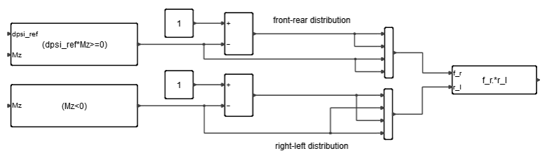

In case of understeering, the front axle is losing grip, therefore the rear wheel is braked while in case of oversteering, the rear axle is losing grip and the front wheel is braked. Thus, by having the turn’s orientation (left or right) and the understeer condition of the vehicle (understeer or oversteer) the optimal tire is selected for braking in order to produce the desired yaw moment. The tire selection algorithm as created in Twin Activate is shown below:Figure 8. Tire Selection from ESP in Twin Activate

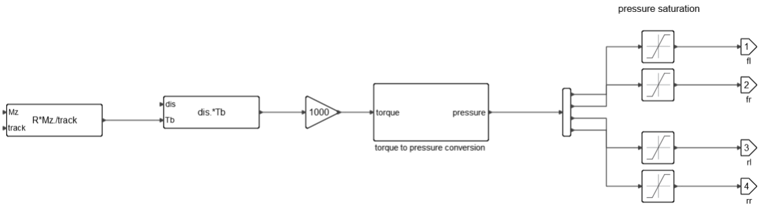

The desired yaw moment for the vehicle should be expressed in desired caliper pressure which will be then produced by the hydraulic modulator. The yaw moment is first expressed in longitudinal force on tire, by using the proper track width (front or rear). Then braking torque using tire’s radius and finally the braking pressure using brake systems parameters. Implementation in Twin Activate is shown below:Figure 9. Yaw Moment to Brake Pressure in Twin Activate

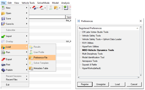

- From the File menu, select .
Figure 10.

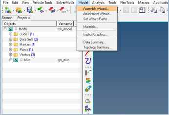

- From the Model menu, select Assembly Wizard.
Figure 11.

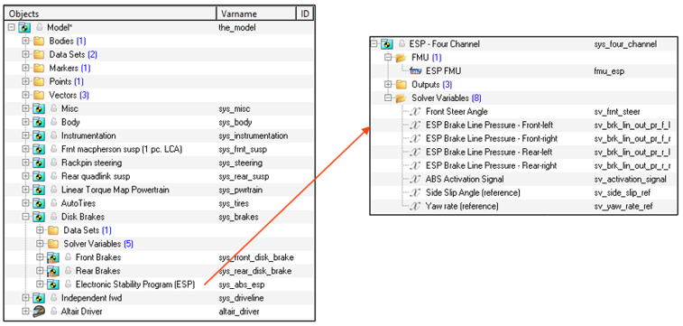

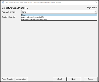

- Under Select ABS/ESP and TC an Electronic Stability
Program (ESP) option will be available for selection.
Figure 12.

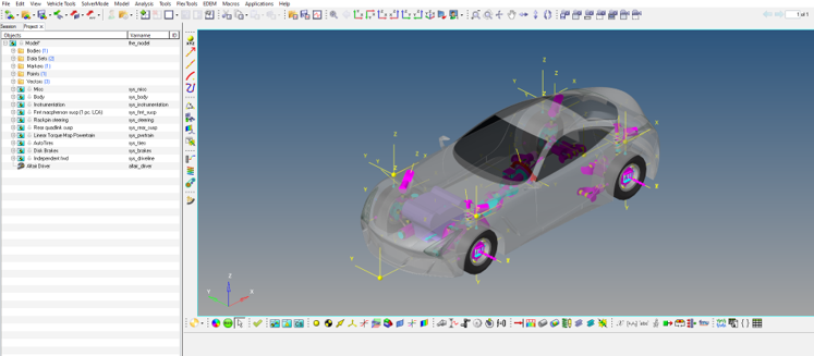

- Completing the Assembly Wizard's selections will lead to a full vehicle model with
Altair Driver and a Electronic Stability Program.
Figure 13.
Figure 14.
