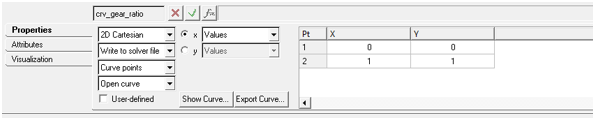

- Gear Ratio Curve: Curve that contains the information about the gear ratio of the
gearbox. This curve is to maintain consistency with the IC Engine Friction Clutch
Powertrain, that models manual transmission. Linear torque map has only one gear ratio.
Gear 0 means neutral gear, and hence gear ratio is not important, since driver would
never shift to gear 0.

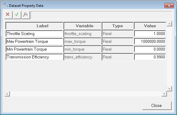

- Powertrain Dataset: Parameters to define the powertrain.
Label Default Value Comments Throttle Scaling 100 Variation of throttle: 0-100, or 0-1, or 0-any value. Driver overrides this value with the value specified in the Altair Driver File under the THROTTLE_STANDARD block, SCALING_FACTOR parameter to maintain consistency between driver output and the powertrain expected throttle input.

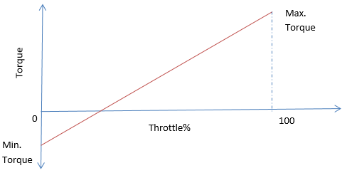

Max. Powertrain Torque 10e6 In model units. Toque output from the powertrain at 100% throttle.
Min. Powertrain Torque 0.00 In model units. Toque output from the powertrain at 0% throttle.
Transmission Efficiency 0.99 Input omega/(output omega*Gear ratio). Figure 3.

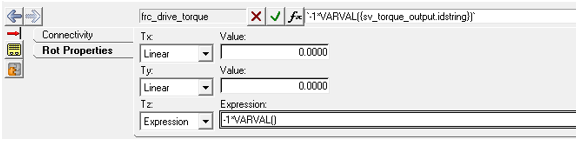

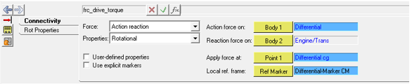

- Differential Torque or Drive Torque: Torque output of the powertrain.
Figure 4.
Figure 5.
Tz – Expression = ‘-1*VARVAL({Torque Output Solver Variable IDstring})’
