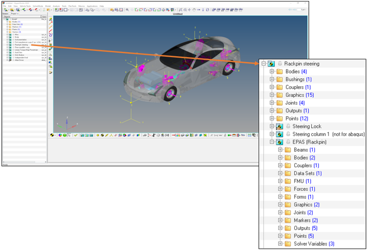

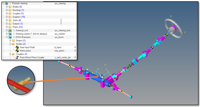

An Electric Power Assisted Steering System of a double pinion configuration is available in the Assembly Wizard plug-in for a Rack-pin style steering system in the Car/Small truck library and a Pitman steering system in the Heavy Truck library.

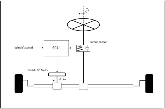

The EPAS electronic control unit calculates the desired assist torque as a function of driver’s torque, measured by a torque sensor placed on steering column, and vehicle’s speed.
- Electric Motor
- Electronic Control Unit
- Torque Sensor

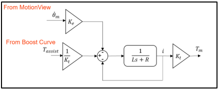

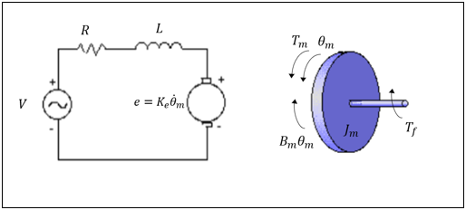

A simple electric DC motor is governed by two main dynamic equations:
where
and
are inertial and damping constants of the motor,
and
are inductance and resistance of motor armature winding,
is the armature current,
and
are t he back EMF and torque constants of the motor,
and
are the electromagnetic torque created by the motor and the counter balance torque acting
on motor shaft due to tire forces.
on pinion due to tires lateral force.
- The Twin Activate motor part uses motor’s angular velocity to
calculate the back EMF voltage while with current value feedback the desired electrical
torque is exported.

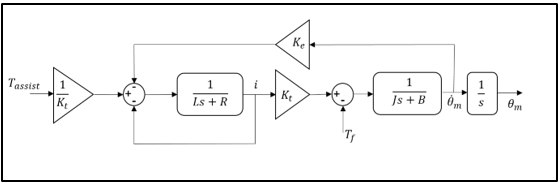

Figure 4.
- The MotionView motor part contains a body to represent
motor’s inertial properties and a rack and pinion coupler with the rack body to interact
with the system.
Figure 5.

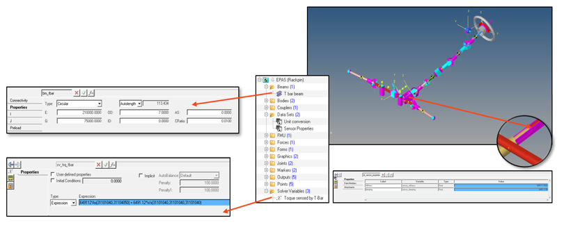

The MotionView diagram and the FMU used in MotionView model can be accessed from this location within the installation: <install_dir>\hwdesktop\hw\mdl\mdllib\Common\FMU_Library\EPAS\FMU_source
Torque Sensor
| Parameter | Default Value | Unit |
| Young's Modulus (E) | 21000 | ![]() |
| Shear Modulus (G) | 75000 | ![]() |
| Outer Diameter (OD) | 7 | ![]() |
| Inner Diameter (ID) | 0 | ![]() |
| Damping Coef (CRatio) | 0.01 | - |

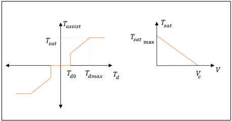

Boost Curve
, increasing linearly until value
which is reached when
value is also decreasing linearly with the vehicle’s longitudinal
velocity in order to maintain vehicle’s stability and controllability. Driver’s input torque
and vehicle’s velocity
are the plant output variables from vehicle’s model in MotionView.

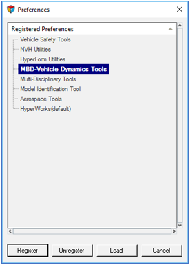

The MBD-Vehicle Dynamics Tools must be loaded as a preference file.

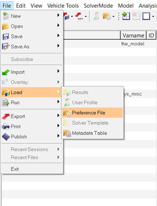

The Update Model utility is only available when the profile MBD-Vehicle Dynamics Tools is loaded. Follow the steps below to load this profile and access the utility:
From the Menu bar, select .
Figure 8.
Choose the MBD-Vehicle Dynamics Tools profile and click
Load.
Figure 9.

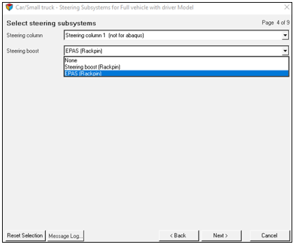

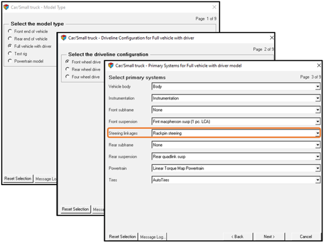

In the Model Type window, select the following:
In steering subsystems EPAS (Rackpin) will be available
as a Steering boost method.
Figure 12.
Other options for the model systems are left to your discretion.
Completing the Assembly Wizard’s selections will lead to a full vehicle model with Altair Driver and an Electric Power Assisted Steering System.Figure 13.

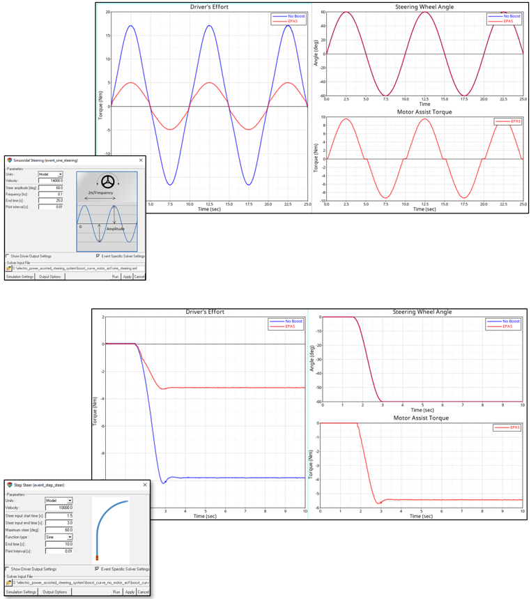

Steering maneuver simulation such as Sinusoidal Steering or Step Steer events can help you understand the behavior of an EPAS system. In the following diagrams these two events are presented for the displayed event settings and the results are compared with those of a vehicle with no steering boost system, performing the exact same maneuvers.
Figure 14.
