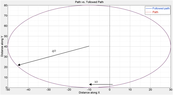

TYPE = 'CONSTANT_RADIUS'
RADIUS = 40
INITIAL_STRAIGHT = 10
ENTRY_ANGLE = 0.39
The vehicle follows the path as shown in the figure below:Figure 1.

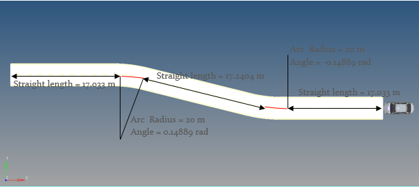

[PATH]
{KEY PAR0 PAR1}
'ST' 17.033191 0.000000
'ARC' 20.000000 -0.148890
'ST' 17.240436 0.000000
'ARC' 20.000000 0.148890
