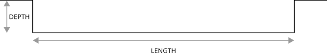

- POTHOLE
- A single pothole of rectangular shape.
If ROAD_TYPE = 'POTHOLE', then the 'DEPTH' keyword must be specified. Depth can be positive indicating a depression or negative indicating a bump in the road.
Add a table for pothole like the one below with corresponding terms:Keyword Description DEPTH Positive / negative depth of the obstacle. Figure 1. Pothole Illustration

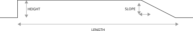

- RAMP
- A single ramp, either rising or falling.If ROAD_TYPE = 'RAMP', then the following parameters must be specified:
Keyword Description HEIGHT Height of the ramp. SLOPE Slope of ramp in deg(°). Figure 2. Ramp Illustration

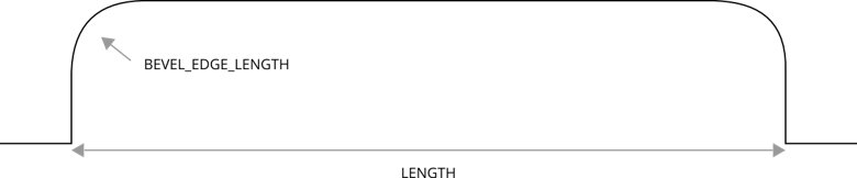

- PLANK
- A single plank perpendicular, or in oblique direction relative to x-axis, with or
without bevel edges.If ROAD_TYPE = 'PLANK', then the following parameters must be specified:
Keyword Description HEIGHT Height of the plank. BEVEL_EDGE_LENGTH BEVEL_EDGE_LENGTH < 0, 3D Spline Road uses rounded corners instead of beveled edges. In this case, the radius of the corner is BEVEL_EDGE_LENGTH. Figure 3. Edged Plank Illustration
Figure 4. Rounded Plank Illustration

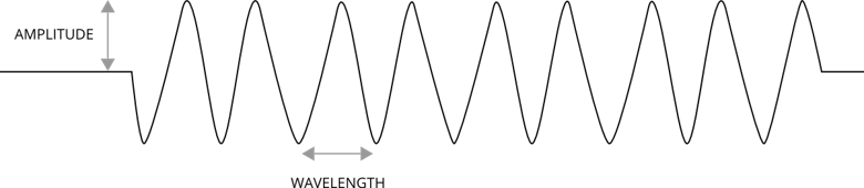

- SINE
- Sine waves with constant wave length.If ROAD_TYPE = 'SINE', then the following parameters must be specified:
Keyword Description AMPLITUDE Amplitude of the sine wave (A). WAVE_LENGTH Wave length of the sine wave (
).START Start of the sine waves (travel distance) (s_s). The road profile height z, is given by:
Figure 6. Sine Illustration

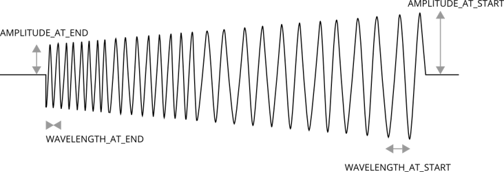

- SWEEP
- If ROAD_TYPE = 'SWEEP', then the following parameters must be specified:
Keyword Description AMPLITUDE_AT_START Amplitude of the sine wave at start (
)AMPLITUDE_AT_END Amplitude of the sine wave at end (
)WAVE_LENGTH_AT_START Wave length of the sine wave at start (
).WAVE_LENGTH_AT_END Wave length of the sine wave at end (
).SWEEP_TYPE If SWEEP_TYPE = 0, then the frequency changes linearly. If SWEEP_TYPE = 1, then the frequency changes logarithmically.
Depending on the value of SWEEP_TYPE, the road profile height is given by the following functions:- Linear Sweep
- The frequency changes linearly with distance
s. The road profile height z is
given by:
- Logarithmic Sweep
- With every cycle, the wavelength decreases by a constant factor.
The road profile is given by:
where,
is the distance at which,
theoretically, an infinitely high frequency is reached, with
respect to the start ss.
Figure 7. Sweep Illustration
