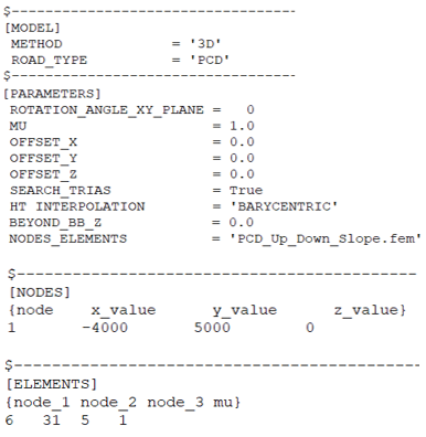

A .fem file exported from HyperMesh in the OptiStruct format can be directly used in MotionView Road Tools to visualize the graphics and pair with any type of MotionSolve Tire models. In this case, the units will be adopted from the MotionView model. It can also be used in the .rdf file format in which the road surface data can be directly fed in the form nodes and elements, or the .fem file can be referred in the .rdf file along with some other information like units, method, coefficient of friction mu, and block parameters.
- UNITS block
- MODEL block containing:
- Method as 3D
and
- ROAD_Type as PCD
- Method as 3D
- An optional PARAMETERS block containing the following:

- TABLE in the same .rdf file.
- File with NODES and ELEMENT data.

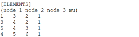

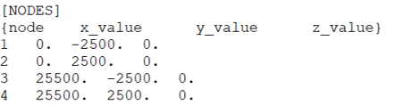

- TABLE
- The NODES table consists of four columns. Column 1 being the node number/node
count, nodes are vertices. Column 2, Column 3, and Column 4 being the x, y, z
coordinate of the vertices of the triangle element.
Figure 3. Nodes Table
The ELEMENTS table consists of four columns. Column 1, Column 2, and Column 3 being the node ID of the vertices forming the triangle element. Column 4 contains the coefficient of friction of the particular element (this information is not passed to the tires currently).Figure 4. Elements Table

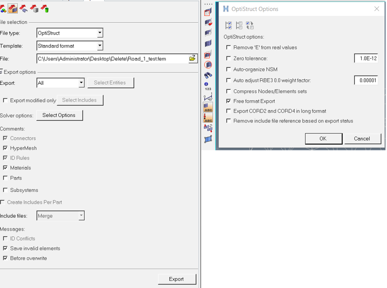

- File with NODES and ELEMENTS

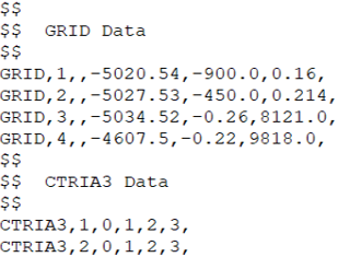

- The file should be exported from HyperMesh using
the OptiStruct
.fem file with "Free format Export" selected as shown in
the figures below:
Figure 5. HyperMesh Selections for Exporting Node and Element Data
This will export a .fem file with the data as shown below:Figure 6. Node and Element Data from HyperMesh in OptiStruct Format

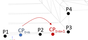

Figure 7. Height Interpolation Schema
The Figure above illustrates a cross section of a road surface. CP is the tire contact point lying on a flat surface. P1, P2, P3, and P4 are four points on the road. The height of the road will be interpolated considering the closest three points of the CP. If CP is between the point P1 and P2, the height will be interpolated considering points P1, P2 and P3. If instead CP is between point P2 and P3, the height is computed using P2, P3, and P4. By controlling the mesh, it is possible to provide more accuracy on the height interpolation and as a consequence the detailed representation of the road.
- The number of mesh elements can be controlled by creating a mesh. This will help in reducing the number of elements to be searched. The elements are cached for future reference as well. This helps in improving the CPU time. In case of points, as there are no elements, there is no data available for a quick reference.
- Repeatability is present even if the CP shifts slightly between different simulations due to numerical approximations. As long the shift is within the element there will be no difference in the output value. This however cannot be guaranteed with only points, for instance if a new road point is closer, the search method will use this new point and the interpolated height will be different from the previous simulation.

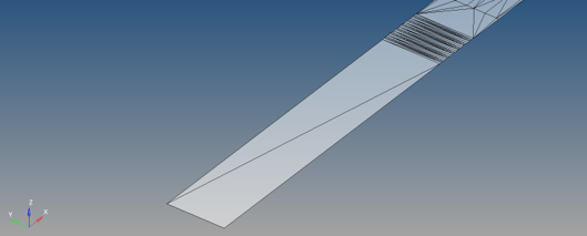

- Use smaller elements to capture the curvature of geometry and use big elements on the
flat surfaces to reduce the total elements count.

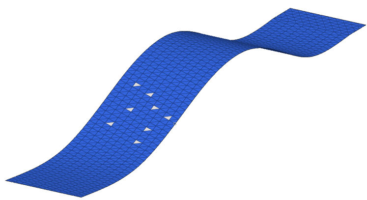

Figure 8. Big elements for flat surfaces and smaller elements for capturing curvature

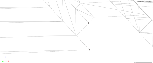

- Try to avoid exactly vertical elements where there are nodes lying on the same x,y
point. Instead try to provide a small difference in the bottom and top nodes.
Figure 9. Avoid exactly vertical nodes as shown
