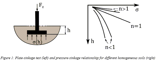

Pressure-Sinkage Relationship
If a terrain is assumed to be homogeneous, its pressure-sinkage relationship (the result of the plate-sinkage test) may take one of the forms which are shown in Figure 1, and it may be characterized by the following empirical equation proposed by Bekker. [1]
Where
is pressure,
is the width of the rectangular contact patch area,
is sinkage, and
, and
, are pressure-sinkage related parameters.

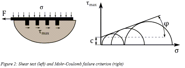

Soil Failure
There is a variety of criteria proposed for the failure of soils. One of the most widely
used is the Mohr-Coulomb criterion which states that the maximum shear strength
of the soil is:
Where
is the apparent cohesion,
is the normal stress, and
is the angle of internal shearing resistance of the material. The
aforementioned parameters can be derived with a shear test for different pressures, as shown
in Figure 2:

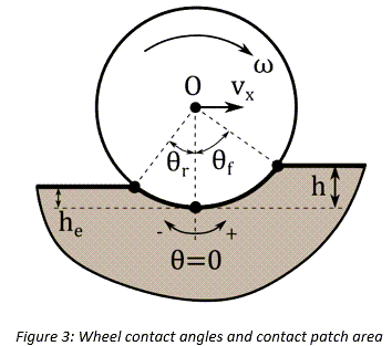

In the case of a moving wheel, the contact patch area can be determined as a function of
sinkage
, the tire’s radius
, and elastic sinkage
using the following equations:

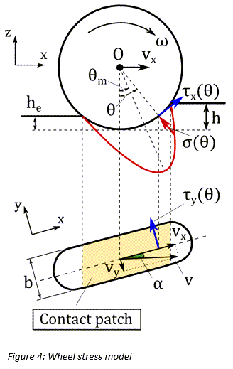

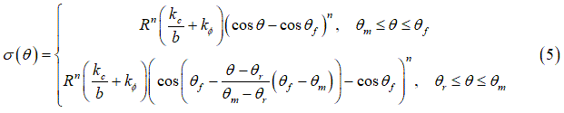

Normal Stress

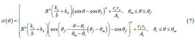

Using the pressure-sinkage relationship proposed by Bekker (Eq. (1)), the tire normal
stress distribution can be calculated as a function of wheel angle
[2]. Specifically,
where b is the tire’s width. Moreover,
is the wheel angle at which the normal stress is maximized [2]
and can be determined as:
In the above equation,
and
are parameters that depend on the wheel-soil interaction,
is the longitudinal slip, and
is tire entry angle.
Furthermore, Eq. (5) can be modified in order to account for the contribution of soil damping [3]. In that case, the normal stress distribution is given by:
Where
is the soil damping,
is soil’s compression rate/velocity, and
is the contact patch area.

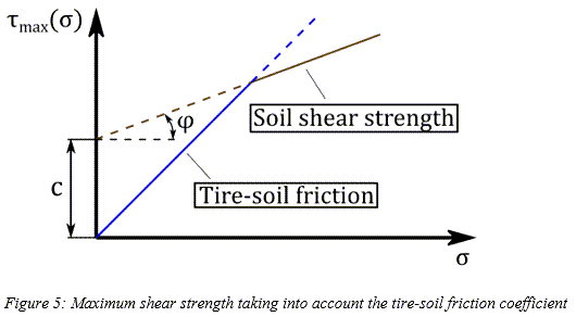

Influence of the Coefficient of Friction
As already mentioned, the maximum shear strength of the soil
can be calculated using Eq. (2) based on the Mohr-Coulomb failure
criterion. In addition, the maximum shear strength between the tire and the soil
can be approximated as a function of the pressure
and the friction coefficient
Consequently, the minimum shear strength (soil–tire and internal soil) is used for the shear stress calculation in order to account for the friction between the tire and the soil [4].
The friction coefficient
normally has a value between 0.3 and 1.0 and largely depends on
the material of the tire and the water content of the soil [4].

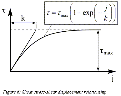

The shear stresses
and
are calculated using identical expressions [5], [6].
In the above equations,
and
represent the shear deformation modules, which are provided by

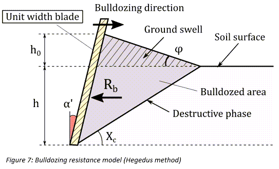

Bulldozing Resistance
Bulldozing resistance is developed when a soil mass is displaced by the wheel. Regarding
lateral forces, due to tire’s sinkage, a bulldozing force which acts on the side of the
wheel must be added to the shear force exerted on the contact patch due to the tangential
stresses
. In this tire model, the Hegedus resistance estimation method
[11] is used in order to calculate the bulldozing force. As depicted in Figure 7, a
bulldozing resistance
is developed per unit width of a blade, as the blade moves toward
the soil, given by the equation:
Where
is the soil density. Moreover, the destructive angle
, based on Bekker’s theory [12], can be approximated as:

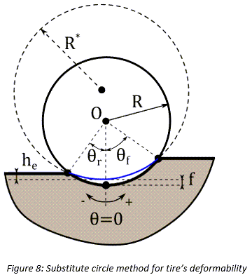

Tire Deformability
In order to account for tire deformability, a larger substitute circle is used to describe the contact patch between the tire and the soil [1], [4], [13], as depicted in Fig. 8. In order to calculate the diameter of the substitute circle, an iterative procedure is followed until the soil vertical reaction force and the tire vertical force are balanced. The former is calculated from an integration of the normal and shear stresses in the contact patch area, while for the latter the vertical tire stiffness is used along with the tire’s deflection. More specifically,
The last three equations are solved iteratively until:
Where the tolerance
is a function of the tire’s maximum vertical load. If the tire’s deformation is
negligible, you can set the boolean flag RIGID_MODE= 'TRUE' in the tire’s
parameter file in order to simplify and accelerate the calculation of the vertical force
. Specifically, no iterations are required since only Eq. (18) is
used in which the quantities
and
are replaced by
and
respectively. By default, the aforementioned boolean flag is set
to FALSE, making use of the substitute circle concept and thus providing
an increase accuracy.

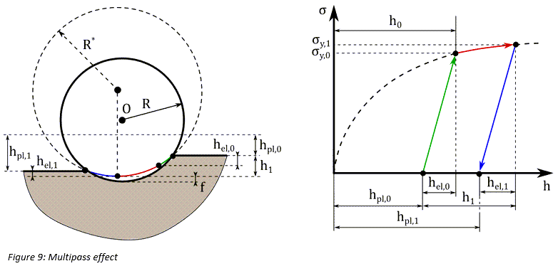

Multipass Effect
For the multipass effect, the response of the soil to repetitive normal load needs to be
established. Specifically, the mathematical description of the normal pressure distribution
must be modified in cases of existing pre-compaction of the soil. As shown in Fig. 9, the
normal pressure distribution will be comprised initially from an elastic part
, which is equal to the elastic (unloading) sinkage that a
previous tire has created. Then the pressure-sinkage relationship continues according to Eq.
(1). Finally, an unloading elastic part
is encountered.
As already mentioned, one part of the induced soil deformation is elastic (elastic sinkage), and the remaining part (plastic sinkage) is irreversible. The elastic part is provided by the equation:
Where
is the soil elastic stiffness.
If the multipass effect is not of interest, you can set the boolean flag MULTIPASS='FALSE' in the road data file. By default, this flag is set to TRUE in order to enable updating the road data.

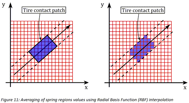

Tire-Road Contact Method
There are two available contact methods in the soft-soil tire model. The required outputs
for both contact models are the soil elevation and the local inclinations of the road
surface
. The default option is to collect all the spring regions that
belong to the contact patch area and use an averaging process to calculate a representative
value for the soil elevation. This is accomplished through a Radial Basis Function (RBF)
interpolation. Moreover, using this approach, the local inclinations of the road surface
can be calculated in an efficient way [14].

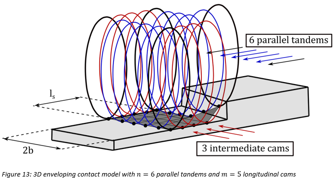

The second option is to use the 3D Enveloping contact method [15], [16]. This contact model
can provide improved accuracy in cases of short wavelengths (sharp steps) in road height.
However, it is a more computationally expensive approach in comparison to the aforementioned

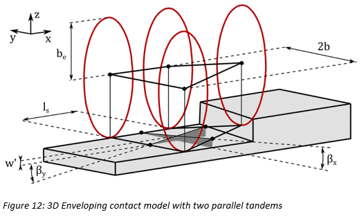

RBF interpolation method. The core idea is to use a series of ellipses to scan the road
profile and produce an effective road plane which is defined by three quantities. Namely,
the modified effective height
, the effective forward slope
and the effective road camber angle
. The simplest form of this contact model is depicted in Fig. 12,
for which:
Where
is the cam center height.
In general, two parallel tandems are not sufficient to obtain accurate results for sharp irregularities. Therefore, more parallel tandems as well as intermediate cams are added, as depicted in Fig. 13. Intermediate cams between the left and right sides are not necessary since their contribution cancel out when calculating the effective road camber angle [15]. The same equations as presented for the previous simple enveloping contact model apply again, but now extended for the case of multiple parallel tandems and intermediate cams. Specifically,

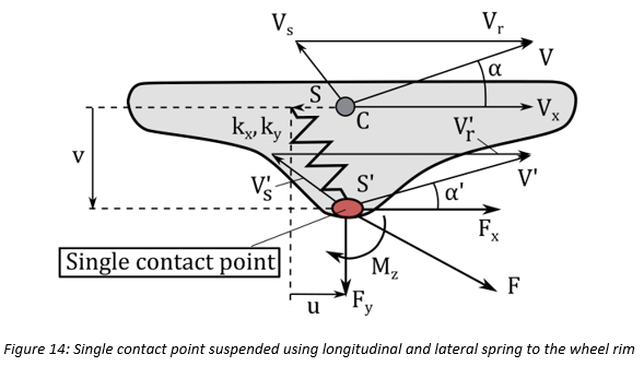

Transient Model
A transient model, as described in [16], has been incorporated in this tire model in order
to enhance its behavior at low velocities. The core idea is that the contact point is
connected to the wheel rim with a longitudinal and a lateral spring, which represent the
compliance of the tire’s carcass. Specifically, as depicted in Fig. 14, the contact point
is connected using these springs to the wheel slip point
, which is attached to the wheel rim. The difference of the slip
velocities of the points
and
produce the carcass springs’ deflection. Subsequently, for the
time derivatives of the longitudinal and lateral deflection,
and
respectively, it holds that:
After proper transformation [16], the previous set of Ordinary Differential Equations (ODE’s) take the following form:
Where
and
are the contact patch slip quantities which will be used instead
of
and
respectively and
are the longitudinal and lateral relaxation length.
Due to the fact that at zero forward velocity an undamped vibration might occur using the previous equations, an artificial damping has been added in the transient model [16]. In that case, the damped contact patch slip quantity:
is used instead of
. Finally, the transient model has been extended in order to cover
the non-linear range of the slip characteristics. Specifically, the restricted fully
non-linear model [16] has been implemented. For this model, Eq. (36) still applies, but the
relaxation length is replaced by the quantity:
Where
is the value of the relaxation length at
represents the minimum value of the relaxation length, which is
introduced to avoid numerical difficulties and
is the slip value where the peak force is encountered. It should
be noted that, similar equations to Eq. (38) and Eq. (39) apply also for the calculation of
the lateral contact patch slip quantity
It is possible that, during low velocity maneuvers, the solver will encounter convergence difficulties. If this is the case, you should try to change the default simulation parameters. Specifically, decreasing the maximum time step and/or the maximum order might help fix the issue.

CONTACT_MODEL = '3D_ENVELOPING'
$----------------------------------------------------------------------dimension
[DIMENSION]
unloaded_radius = 0.32
width = 0.2
aspect_ratio = 0.45
$----------------------------------------------------------------------parameter
[PARAMETER]
! Name Value Comment (units)
max_vertical_load = 5000.0 $[force]
vertical_stiffness = 150000.0 $[force/length]
rolling_resistance = 0.00005 $[length]
$----------------------------------------------------------------------contact_coefficients
[CONTACT_COEFFICIENTS]
PAE = 0.8 $[-]
PBE = 0.8 $[-]
PCE = 2.0 $[-]
PLS = 0.8 $[-]
MAX_OBS_HEIGHT = 0.04 $[length]
N_WIDTH = 6 $[-]
N_LENGTH = 5 $[-]
N_MESH = 21 $[-]

MotionSolve Output Requests
- F2 – Plastic sinkage
- Permanent compression of soil due to tire dynamics (Length h-he in Figure 3).
- F3 – Long Resistance
- Force contribution of the soil normal stress to the longitudinal force (refer to equation 23).
- F4 – Long Shear
- Force contribution of the soil shear stress to the longitudinal force (refer to
equation 23).
- F6 – Lat bulldozing
- The Bulldozing force acting on the tire’s lateral side (refer to equation 24)
- Lat Shear force
- Force contribution of the soil shear stress to the lateral force (refer to equation
24).
- F8 – Tire Sinkage
- Soil compression at tire contact patch (length h in figure 3).
