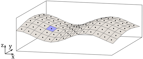

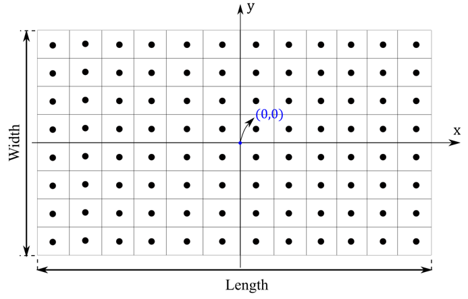

Road Modeling
The soft soil road surface is represented as a rectangular structured grid of deformable springs in the vertical (z-axis) direction, as shown in the figure below. Using this approach, each spring represents a small road patch for which the necessary information is stored.

LENGTH = 300.0 $ Range of soil region in x direction
WIDTH = 5.0 $ Range of soil region in y direction
NODES = 1 $ Number of integration points

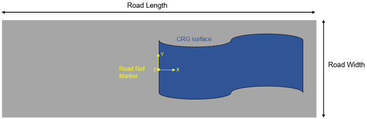

CRG Road Data File
In order to represent complex terrain geometries, the soft soil road model enables the use of curved regular grid (CGR) files. For this, the attribute CRG_FILE=’path to .crg file’ needs to be set in the PARAMETERS block of the road (.rdf) file.
$---------------------------------------------------------------------PARAMETERS
[PARAMETERS]
MU = 1.0 $ Friction coefficient
WIDTH = 6.0 $ Range of soil region in y direction
MULTIPASS = 'TRUE'
CRG_FILE = '<road_path>.crg'

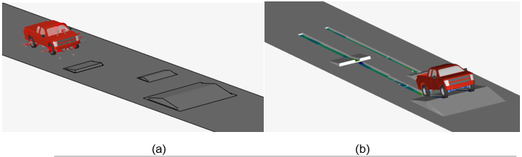

MotionView provides the ability to include soft-soil road deformation in simulations using the soft-soil tire model. The deformable road graphic is created in MotionView using the Road Tools and sent to MotionSolve to simulate the tire-soft-soil dynamics. The soft-soil road deformation can be visualized in HyperView.
The Road Tool supports the creation of flat and Curved Regular Grid (.crg) roads using the road property file (.rdf). It is also possible to include the different obstacle types available in the soft-soil tire model that deforms along with the road depending on the obstacle material. Refer to Obstacles for more information.
Road Positioning
Add a Soft-Soil Deformable Road and Visualize the Results
- Load the soft-soil road property file (.rdf) in the Road Tools
(see the Visualization - Road Tools topic for additional
information). When loading the road property file, an .h3d file and .mdl file are created at the selected path. The road graphics are displayed in MotionView's modeling windows and a graphic system containing the road graphics is defined in the model browser.
Figure 6.
- Add the soft-soil tire and road property files in the Tires entity or use the track builder to create a track system with soft soil.
- Run the analysis in MotionSolve.
MotionSolve reads the road .h3d created by the Road Tools and generates an additional SSR (soft-soil road) file which has the name <MotionSolve_result_xml_name>_softsoil_road.ssr during run time. The softsoil_road.ssr contains the information about the road graphic nodes deformed during the simulation.
- Post-process the analysis in HyperView.
Once the simulation in completed, open the model animation results in HyperView.
