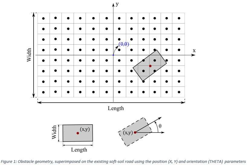

Obstacles
Using the predefined obstacle templates, a variety of obstacle types can be created which are superimposed on the existing soft-soil road geometry.
Implementation
In order to properly position the obstacle, the X and Y coordinate of the obstacle’s center as well as the THETA angle, which defines its orientation, must be provided, as shown in Fig. 1.
By default, each obstacle is created as deformable, making use of the global soft-soil parameters (see Fig. 2). In order to change its default state, the optional parameter MAT can be set to ‘RIGID’ or a user-defined ‘MAT_LABEL’. More specifically, in the first case, the obstacle is rigid (non-deformable) and the tire-rigid road interaction is implemented using the Fiala tire model (see Fig. 3). On the other hand, in the second case the obstacle is still deformable. However, instead of the global soft-soil parameters, a new set of parameters is used for the obstacle’s region which is defined in the new block ‘MAT_LABEL’, as depicted in Fig. 4. Finally, if the block ‘MAT_LABEL’ cannot be found in the road data (.rdf) file, the simulation proceeds using the global soft-soil parameters.

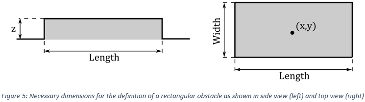

Rectangular Obstacle
To create a rectangular obstacle, a new block (RECT_OBSTACLE block) is necessary in the road data (.rdf) file that contains the following parameters:
| Parameter | Description | Units |
| X | X coordinate of obstacle’s center | Length |
| Y | Y coordinate of obstacle’s center | Length |
| Z | Z coordinate of obstacle | Length |
| LENGTH | Length of obstacle | Length |
| WIDTH | Width of obstacle | Length |
| THETA | Theta (orientation) angle of obstacle | Angle |
| UMIN | Parameter for tire-rigid road interaction (Fiala tire model) | - |
| UMAX | Parameter for tire-rigid road interaction (Fiala tire model) | - |
| CSLIP | Parameter for tire-rigid road interaction (Fiala tire model) | Force |
| CALPHA | Parameter for tire-rigid road interaction (Fiala tire model) | Force |
| MAT | Obstacle’s material. Optional parameter, default value is ‘SOFT_SOIL’ | - |

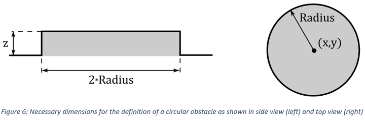

Circular Obstacle
To create a circular obstacle, a new block (CIRC_OBSTACLE block) is necessary in the road data (.rdf) file that contains the following parameters:
| RADIUS | Radius of circle obstacle | Length |

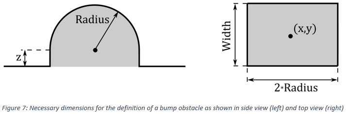

Bump Obstacle
To create a bump obstacle, a new block (BUMP_OBSTACLE block) is necessary in the road data (.rdf) file that contains the following parameters:
| Z | Z coordinate of bump's center | Length |
| RADIUS | Radius of bump | Length |

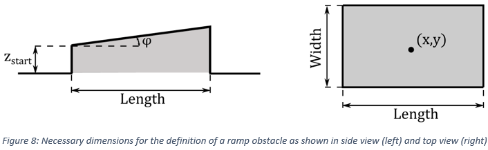

Ramp Obstacle
To create a ramp obstacle, a new block (RAMP_OBSTACLE block) is necessary in the road data (.rdf) file that contains the following parameters:
| Z_START | Z coordinate of obstacle's starting point | Length |
| PHI | Phi (inclination) angle of obstacle | Angle |

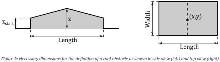

Roof Obstacle
To create a roof obstacle, a new block (ROOF_OBSTACLE block) is necessary in the road data (.rdf) file that contains the following parameters:
| Z | Z coordinate of obstacle's midpoint | Length |

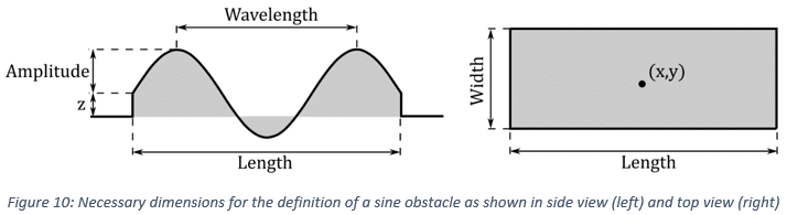

Sine Obstacle
To create a sine obstacle, a new block (SINE_OBSTACLE block) is necessary in the road data (.rdf) file that contains the following parameters:
| AMPLITUDE | Amplitude of sine wave | Length |
| WAVELENGTH | Wavelength of sine wave | Length |

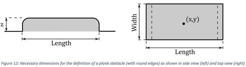

Plank Obstacle
Using a plank obstacle, two different cases can be distinguished regarding the shape of its edges. In detail, beveled edges are used when the BEVEL_EDGE_LENGTH parameter is positive. On the other hand, round edges are created with a negative value of this parameter, where the radius of the corner is equal to |BEVEL_EDGE_LENGTH|.
To create a plank obstacle, a new block (PLANK_OBSTACLE block) is necessary in the road data (.rdf) file that contains the following parameters:
| BEVEL_EDGE_LENGTH | Length of the beveled edge (45° angle). If this parameter is negative, the obstacle is created with round edges, where the radius is equal to |BEVEL_EDGE_LENGTH| | Length |

Ramp Obstacle
$-----------------------------------------------------RAMP_OBSTACLE
[RAMP_OBSTACLE]
X = 0.0 $ X coordinate of obstacle's center
Y = 0.0 $ Y coordinate of obstacle's center
Z_START = 0.0 $ Z coordinate of obstacle's starting point
LENGTH = 1.0 $ Length of obstacle
WIDTH = 0.5 $ Width of obstacle
THETA = 0.0 $ Theta (orientation) angle of obstacle
PHI = 0.087 $ Phi (inclination) angle of obstacle
UMIN = 0.8 $ Parameter for tire-rigid road interaction (Fiala tire model)
UMAX = 1.0 $ Parameter for tire-rigid road interaction (Fiala tire model)
CSLIP = 20000.0 $ Parameter for tire-rigid road interaction (Fiala tire model)
CALPHA = 44000.0 $ Parameter for tire-rigid road interaction (Fiala tire model)
Figure 18: Example of deformable ramp obstacle in road data (.rdf) file
Roof Obstacle
$-----------------------------------------------------ROOF_OBSTACLE
[ROOF_OBSTACLE]
Z = 0.05 $ Z coordinate of obstacle's midpoint
Figure 19: Example of deformable roof obstacle in road data (.rdf) file

Plank Obstacle
$-----------------------------------------------------PLANK_OBSTACLE
[PLANK_OBSTACLE]
BEVEL_EDGE_LENGTH = 0.02 $ Length of the beveled edge
Figure 22: Example of deformable plank obstacle in road data (.rdf) file
