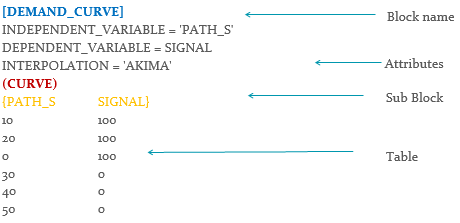

ATTRIBUTE_NAME = ATTRIBUTE_VALUEBlock
Blocks form the most versatile data structure of the reader utility. It acts as container
for all other data members except a block.
- Block can contain any number of sub-blocks.
- Block cannot contain a block.
- Block can contain multiple tables but only by storing them in different sub blocks.
Format:
[BLOCK_NAME]
ATTRIBUTE(s)
SUBBLOCK(s)
TABLEBlock ends with the end of file or start of new Block.
Sub-block
Sub-blocks are structurally similar to blocks with an only difference that they cannot
contain sub-blocks or blocks.
- A sub-block cannot contain more than one table.
Format:
(SUBBLOCK_NAME)
ATTRIBUTE(s)
TABLE(s)Table
Data structure which consists of fields (rows and columns).
- Table can contain any type of attributes.
- In no label is provided, the default is to label them as indices starting from 0.
Format:
{LABEL1 LABEL2 LABEL3}
ATTRIBUTE00 ATTRIBUTE01 ATTRIBUTE02
ATTRIBUTE10 ATTRIBUTE11 ATTRIBUTE12
ATTRIBUTE20 ATTRIBUTE21 ATTRIBUTE22Units
