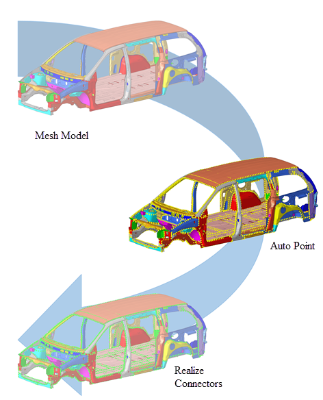

Create weld points at a predefined pitch distance so that the model build process can continue without the need to wait for the published weld data from CAD. The Auto Point tool is useful when working with elements, not geometry.
From the Connectors ribbon, Point tool group, click the Auto
Point tool.
Select the components to automatically add connectors to.
All selected components receive connectors with the same qualities to help you perform a blanket application of connectors – using the same pitch – to all components that need them as a single operation. Be wary of simply selecting the whole model, however, as this could result in undesirable actions, such as adding welds to a car's tires.

The created output is connectors with the appropriate spacing and other associated parameters. The connectors are in the unrealized state.
