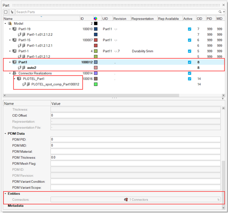

- Part
- If you have placed the Connector into a part, the Connector
will follow the part into its owning Subsystem. The
realization will be created into a new part with the
original part reference in the name within the Connector
Realization Part Assembly.
- Subsystem
- If you have placed the Connector into a Subsystem, the Connector will flow directly into the subsystem. The realization will be created into a new Part with the owning subsystem reference in the name within the Connector Realisation Part Assembly.

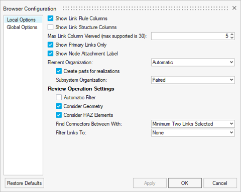

Organize Elements
From the Connector Browser, right-click white space and
select Configure Browser from the context menu.
The Browser Configuration dialog opens.
- Select the Local Options tab in the left pane to display local options.
In the Element Organization field, select the appropriate option.
Figure 3.

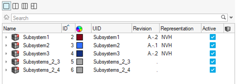

If Automatic is selected for Element Organization,
select one of the following options for Subsystem Organization:
Selection Result Paired Subsystem connectors create subsystems to organize and realize based on connector links. Single Subsystem connectors create a single subsystem to organize and realize. Figure 4.
