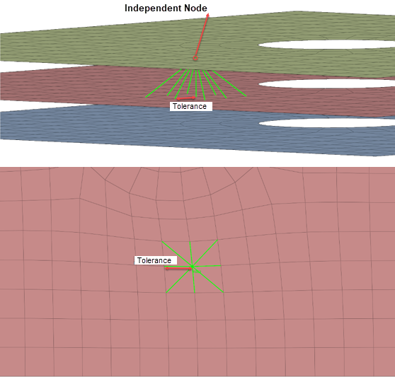

Connect Components with RBE3s
Create RBE3s for connecting structures.
From the Connectors ribbon, Tools tool group, click the
RBE3 tool.
- Optional:
From the guide bar, click
to adjust the tolerance.
- Select the independent node.
- From the guide bar, click Components to pick the component to connect the independent node to.
Click Create.

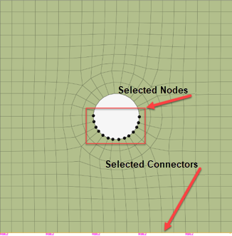

Imprint Nodes and Points on Connectors
Imprint nodes and points as significant points on connectors.
Imprint tool.
Figure 3.
From guide bar, click
The tolerance for projecting the node/point to the connector must be large enough so that the distance from the farthest node to the connector is smaller than the tolerance. - From the drop-down menu, select Nodes or Points to select nodes or points on the model.
Connectors to select the connector(s).
Figure 4.
- From the guide bar, click Imprint.
