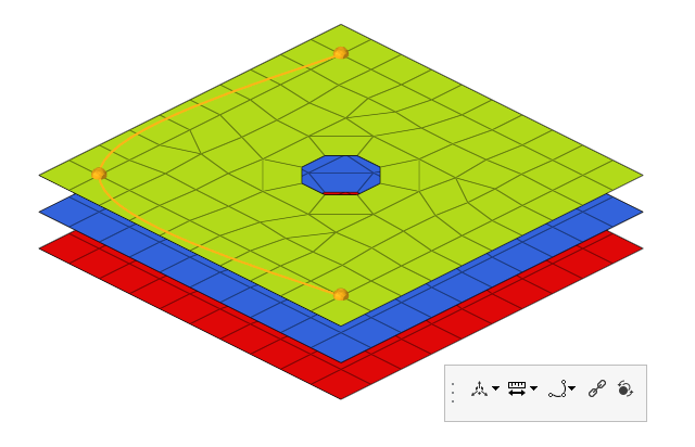

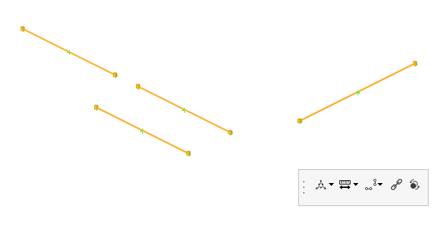

Line Creation - None (
) - Leave the line selections separate.
Figure 3.

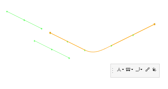

- Combine Smooth (
) - Combine selected lines with an interpolated line.
Figure 4.

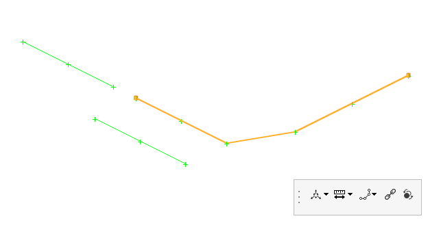

- Combine Straight (
) - Combine selected lines with a straight line.
Figure 5.

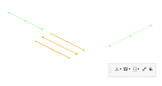

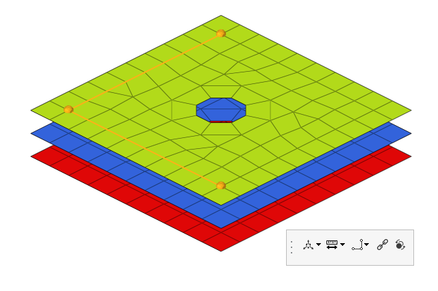

- Mid Line (
) - Generate a midline between selected lines.
Figure 6.

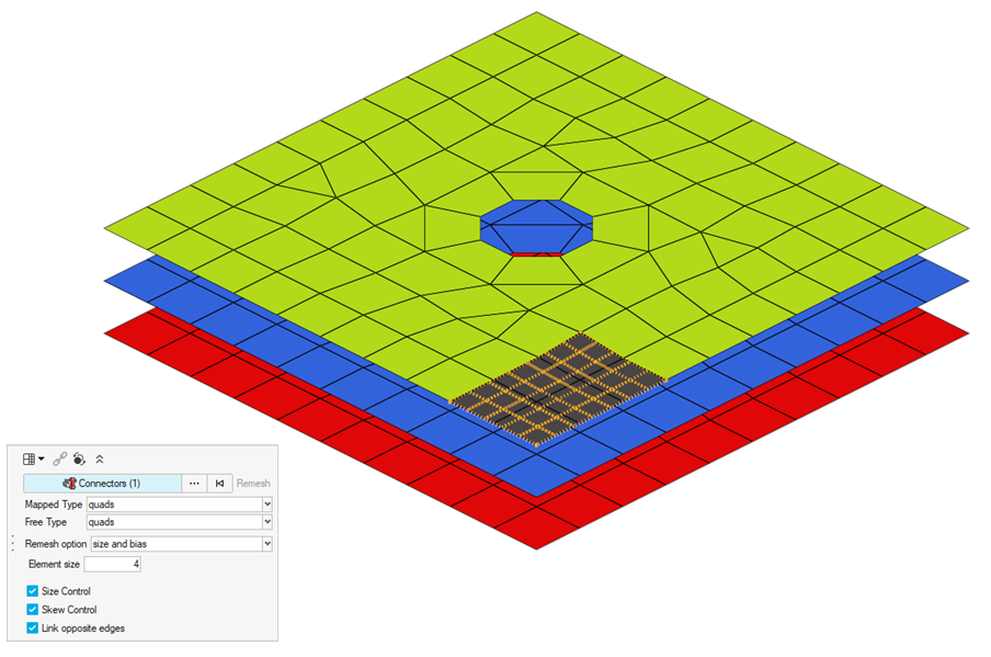

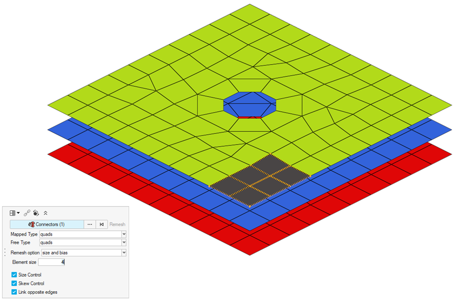

Remesh (
)Remesh the connector surface. Figure 7.
Available for any selection type in the Area tool.
