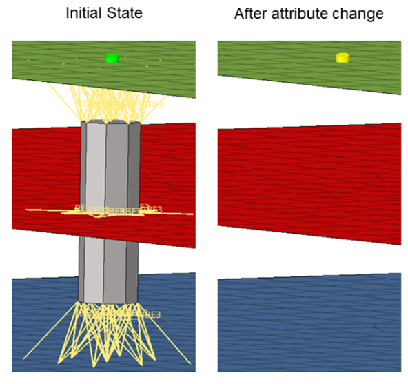

- Unrealize
- Changes the connector state to unrealized in the event of
attribute changes of the links that affect the physical
realization.
- Realize
- The connector re-realizes automatically when a link
attribute is changed that affects the physical
realization.

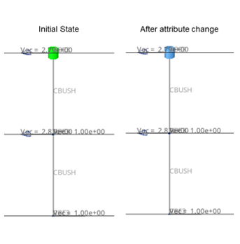

Figure 3.
- Calculation Changes:
- Nothing
- Connector realizations will not react to attribute changes that affect connector calculations.
- Modified
- Changes the connector state to modified in the event of
attribute changes that affect calculations of the
connector.

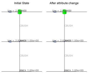

Figure 4.

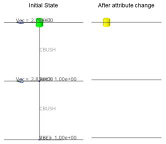

- Unrealize
connector.
Figure 5.

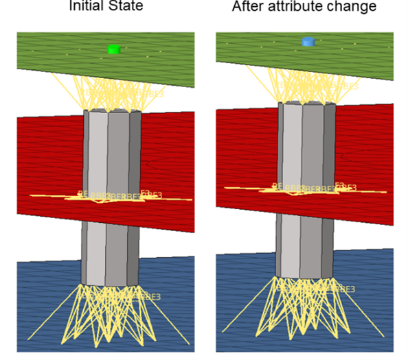

- Realize
- The connector re-realizes automatically when an attribute is
changed that affects the calculations of the connector.
Figure 6.
