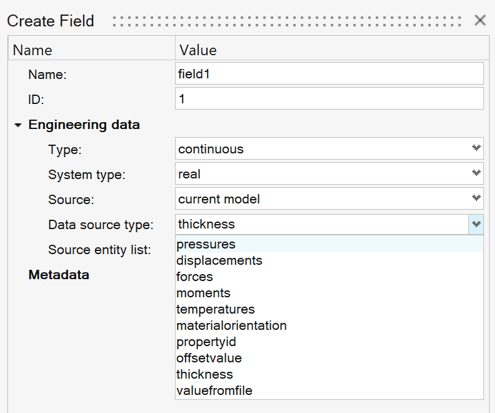

When creating a new field, all of the inputs are defined using the Entity Editor. -
Select one of the following field types:
- Continuous
- The field uses shape functions and the source mesh to enhance the mapping of the data during realization. For sources without a mesh, a mesh is approximated if the data points are reasonably structured.
- Discrete
- Discrete fields are simply handled as point data, just the coordinates and data values at the point locations provided in the source.
Select one of the following system types:
- Parametric
- This should only be chosen if the field source is a .csv file containing data at parametric surface coordinates (u,v).
- Real
- Used for all other sources.
Select one of the following sources to create the field:
- Current Model
- This is most commonly used when transferring data between two
somewhat similar models that are loaded in the same session. With
this option fields may be defined using various entities or
attributes in the model:

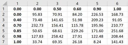

- CSV File

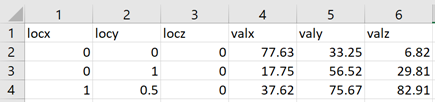

- The format for the .csv files depends on the system type and intended realization type:

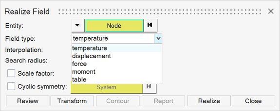

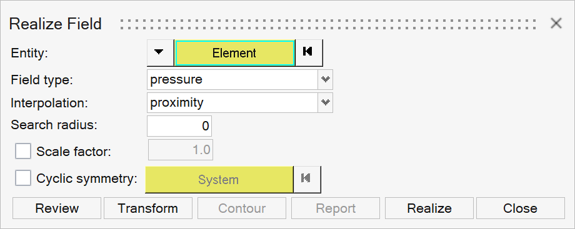

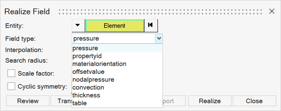

The Realize Fields dialog has multiple inputs and reconfigures depending on the type of realization.
Figure 7.
The first two inputs in this dialog define the “where” and “what” of the realization, and the remaining inputs specify the “how” with various mapping parameters.
- Use the target entity selector to select the nodes or elements to which the field is to be mapped.
Select a field realization type.
Depending on the field source data and whether the target is nodes or elements, different realization types are available to choose.
Figure 8.
Figure 9.
The listed realization types that are entities and attributes are self-explanatory, but there are also a couple of special types: convection and table.

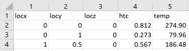

- Convection
- In a convection realization, heat transfer coefficients and temperatures are mapped to the target elements. This option is only available for OptiStruct and Abaqus models, and requires a field sourced either from a convection data .csv file or from an AcuSolve results file.

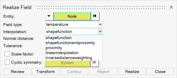

Select a field mapping method, also known as an interpolation.
Several mapping methods are available depending on the field source data, target entities, and realization type.
