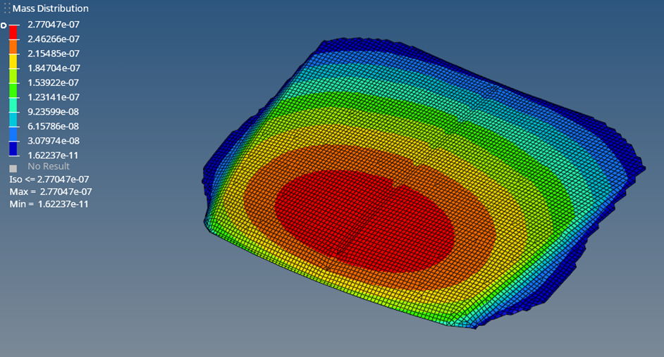

Solver Masses
Solver masses are used to model lumped mass finite element mesh.
Solver mass entities have a display state, on or off, which controls the display of these entities in the graphics area. The display state of a Solver Mass entity can be controlled using the icon next to the entity in the Model Browser.
