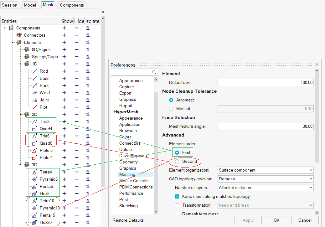

By default, first order elements are created and solver specific element types/configs are parsed from the element type panel. In order to create second order elements, set the meshing element order preference to Second.Figure 5.
