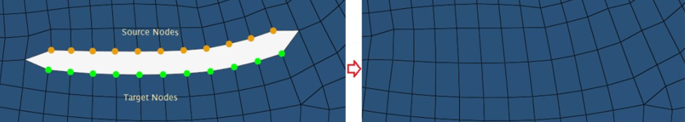

Multi to Multi - Select source nodes by path to relocate and replace.
- Select target nodes by path.
- Click Replace on the guide bar to replace all nodes at once.
