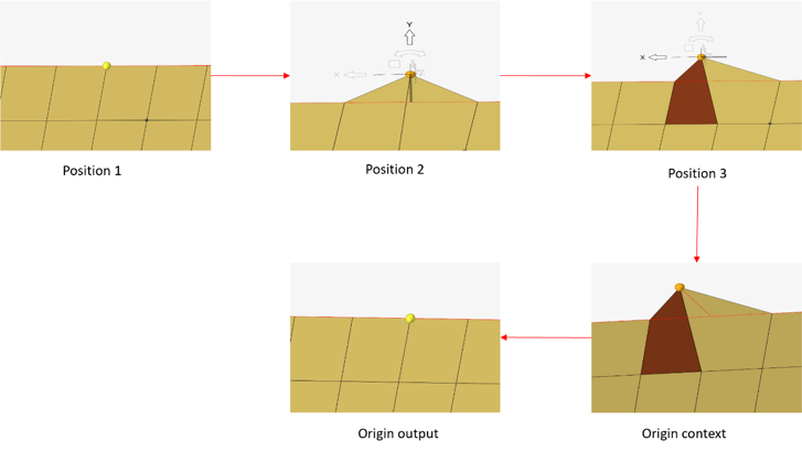

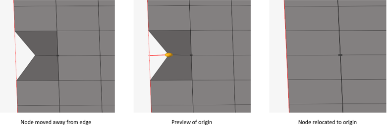

Relocate Nodes/Elements to their Initial Locations
Use the Edit Elements: Origin tool to relocate moved nodes and elements to associated geometry.
From the 2D ribbon, click the tool.
- Select nodes or elements.
Click
on the guide bar.
Note:- If nodes are moved within the surface/edge, the current position of the node is updated as the origin. Therefore, nodes are not moved back to their initial locations upon using the Origin tool.
- If nodes are moved away from the surface/edge, nodes are always
brought back to the initial locations upon using the Origin
tool, even after multiple node movements.
Figure 3.
