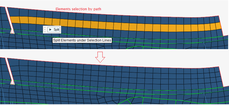

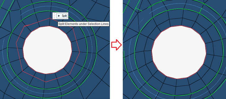

Graphical Lines - Draw continuous single or multiple graphical split lines.
- Click Split.

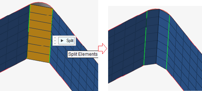

Figure 3.
Note: When you split elements at fillets or curved faces, the middle nodes are projected back to parent edges/surfaces by default upon splitting.Figure 4.
